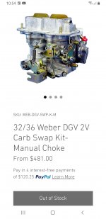

DUI distributor calls for an upgrade to the single Autolite 1100...I was hoping to purchase the Weber 32/36 conversion with manual choke but no one seems to have one available. I know the come from Spain and its been almost a year now that Vintage Inlines has been "out of stock".
Now what ?? Anyone have any ideas as to how I can continue to move forward ?20220111_162003.jpgScreenshot_20220112-105407_Samsung Internet.jpg

You can try contacting Red Line Weber Carb's in California they have been in bussness for many years. http://www.redlineweber.com
There are also some do it yourself manual choke converstion kits made to use on the Weber 32 / 36 and the 38 / 38 carb's here is one example. https://www.ebay.com/itm/MANUAL-CHO...-/272523066682?_trksid=p2349624.m46890.l49286
Best of luck on your Falcon
Excellent...just emailed them. We'll see. If I don't hear from them I'll give them a call.

I'm pretty much following the Ford inline six Performance manual. Matt over at Vintage Inlines got back to me and is checking the status of thr 32/36 carbs. He may have to order the automatic choke models and purchase the manual choke conversion kits to change it over. It would be great if he comes through. Fingers crossed.16420788332861658092242919018150.jpg

That might be tough given it's going on a small log like the Falcon. Matt over at Vintage Inlines is checking status of current stock and will get back to me.
