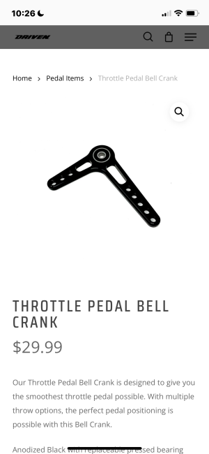

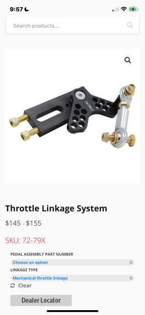

I was thinking of using as much of the original linkage as possible and make a bell crank arrangement on the right side of the engine.
I have to think some more about this.

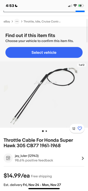

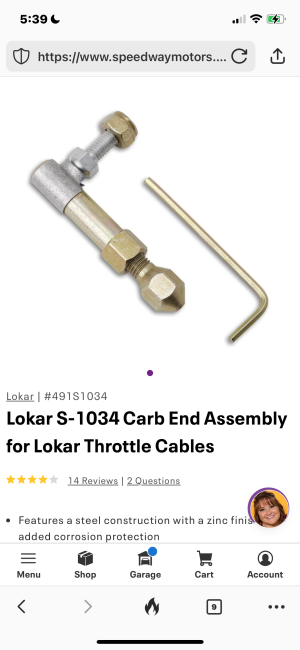

I have thought about this too. Use original 67 mustang linkage, then make a 90* bend. Keep us posted 👍
Ideas:

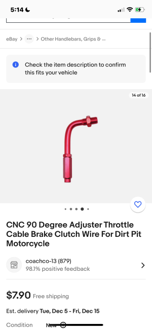

Using just a small length of cable for the bend only🤔
