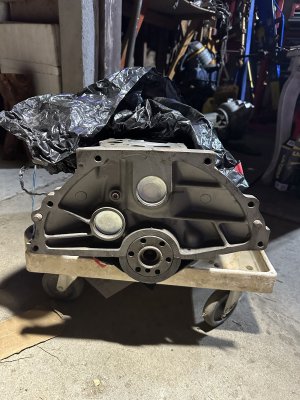

did you get to actually 'eyeball' the bellhouse / starter on the engine - any pics ?
'81 small block six had both low starter , unique BH 200 and the more typical 'dual drilled' high starter 200 afaih ...
not to sure which one it is yet haha. but I do have some photos
Hi, most of the Ford six engines, and all of the early engines have a "high mount" starter, and a place to mount the ball for the clutch Z bar, and either an early single, or later dual bolt pattern to mount the bell housing Some of the later engines, and all of the 250s have the small block Ford (SBF) bolt pattern, with the starter mounted low, below the oil pan rail. Some do not have the hole for the clutch linkage ball. All the other parts interchange. Your old head will have a smaller combustion chamber, but also a smaller carb openings, 1/12" vs 1 3/4" on later heads, so the carbs won't interchange. Many guys mill the newer heads to get a combustion chamber of @ 53 CC. The later
Hi, that is the SBF style block, What tranny are you running? Good luck
That is 2/3rds of a SBF not a SBF bell block, but they can be modded to fit. 67 flywheel will bolt on but the starter will not bolt any where near the ring gear. There is ways of making things work.

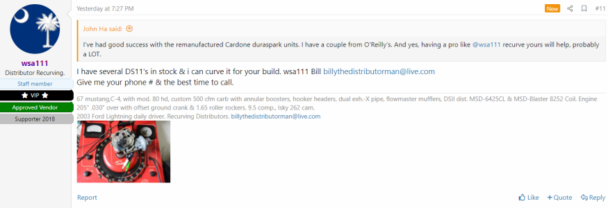

That 81 block is a good find and getting harder to find, I am looking for one myself. What vehicle are you working on? The Ford DSII ignition system is popular and is what I have on my Bronco. wsa111 is a member here and can provide the DSII distributor custom curved for your application and can advise on the balance of parts. I've noticed many are now using the GM module instead of the DSII module as they are smaller, cost less and easy to find from what I understand.

Rn I have a C4 but it doesn’t fit so I plan on getting a new bellhousing and a T5.
Some mods will be needed. See if you can contact ''gus91326'' I think he did this mod.
The oil pump should fit fine, not familiar with 67 200 but if you use all of your 67 acc. then the water pump and damper should work as the front of the BB block is the same. The fuel pump will fit fine.
... small block 250 with SBF V8 pattern - 81 200 subtle difference ? - 81 200 looks shorter to block deck than SBF / 250 Bellhouse ?.
Yes the 81 BB block the two top holes are lower than a SBFV8 bellhousing. People have redrilled the top two holes of the SBFV8 bellhousing, then you need the MDL billet small six 157 tooth 10'' or 10something metric clutch flywheel to work . A bracket is needed for clutch cross shaft block ball pivot , there is no boss on the bb block for one.
