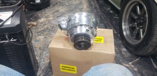

Went Out to the shop this morning to take a picture of the Paxton install kit . After looking at it last night & going thru the copy of I guess an orignal Paxton install guide for Falcons & Comets it seems non of the parts for braceing the Paxton are Supplied .
That should be the easy part after looking over the paper work . After watching a video on facebook of an install with a complete kit includeing the Paxton you most definitely need the braceing or run the risk of breaking off the one ear on the bracket where it attaches to the t,stat houseing . That blower was pull in toward the front core support in a bad kind of way.
