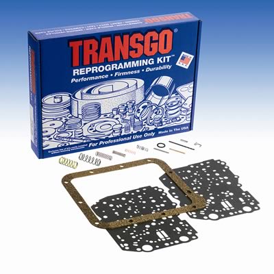

Yes that would be a good time to fix the Selector seal too. There are 2 TransGo Shift Improver Kits available for the 1967 to 1969 C4 Select Shift Valve Body's and a third that turns it into a Manual Valve Body. I usually also install a small Transmission Cooler too especially in the Hotter Areas like the South West. I have been using them for decades now and even grew up 3 blocks from the company's location.
47-1 Reprogramming Kit™
With Gear Command™
Fits all C4 1967-69
https://transgo.com/product-details/47-1/
47-2 Reprogramming Kit™
With Gear Command™
Fits all C4 1967-69
https://transgo.com/product-details/47-2/
  • Has slightly firmer shifts than above #47-1 Kit
Also since your Car is Supercharged you could also use this VBP-Vac Kit to protect the Vacuum Modulator .
https://transgo.com/product-details/vacuum-bypass-kit/

Bubba who is my go to for the c4 kits? I checked those links & it said they do not sell direct.
Sounds like I need ( want) one after reading the literature ,& my little bit of driveing the car.
Thanks for the info
Wayne
Hi Wanye clark, in the top right hand corner of the above links I posted is a Tab "Where to Buy" by clicking on that shows the Tab "Authorized Distributors". Or in each of those product links is a Tab at top right side of the page "Distributor Part Numbers" if you click on that it also shows all of their Parts Sources. Best wishes.

Got some trans parts & a pressure relief valve coming after reading Bubba's post the other day .

Well I've had a little drive time with the Paxton . I did order the transgo parts Bubba suggested, installed the pop off valve for the trans modulator only as of now .
