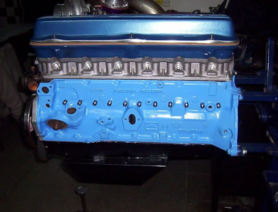

A guy named mike1187 (posted in the turbo section) showed how he installed roller lifters on a 250.
Warranted or not, you have think about the compatibly of the billet steel cam gear and the iron dist. gear, there is no bronze gear for the small six, there is some melinized sp? gears that may work.
Mike used an external drive crank driven oil pump that takes the load off the dist. gears and the Argentine guys seem to run external pumps too.

I looked at this for the small 6 cylinder Ford, and many automatically assume you have to use a tie bar link setup to run a roller cam, but you dont. The setup used by the 5.0 302 can work good as well as the keyway style. The keyway style being a last resort in my opinion because of costly machine work. But the 5.0 method is simpler and most anyone can do it themselves with little effort or exotic tools....I was seeking a donor block and had countless hours of conversations with Donnie Johansson about making round lobe billet blanks for this engine and several other niche inline engines I was looking to bring this type of product to market. I saw the writing on the wall 10 or so years ago that people are just now starting to realize and take seriously....
I don't see how there is room for dogbone retainers. What about cylinder 1 and 6 where there is a boss ? Also a flat pad to set on.. I think the link bar on the outboard side is most feasible. You might have to load lifter from bottom and manipulate link bars on. Getting a camshaft is actually the biggest obstacle imo.

Well, as mentioned in a post farther up in this thread, another member already installed a roller cam in his earlier build. It's been done before in the small Ford six. I also had spoken to several cam companies myself about having roller cam blanks made, including Donnie Johansson, who is a legend in the Bonneville scene for creating roller cams in numerous vintage inline engines that never had them before. Plus, there are several cam companies in Oz that have them for years. One of those companies is where Mike in the build thread mentioned got his cam. So, it's not really as big of an obstacle as you might think.
Keep in mind that Mike was using a crossflow AU. head with the different valve layout and the cam was something that was already in production( I think).
