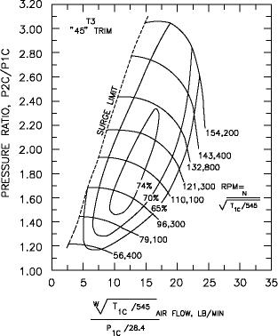

I did a little research, and what I found was this: It is a Garrett T3, either 40 or 45 trim. .48 turbine A/R, .45 compressor A/R. This is a pretty small turbo, so it should have excellent spool characteristics at the expense of top end restriction.
Compressor map:
To use this, you calculate the CFM that the engine will use, and plot that on the map. You want to be in the highest efficiency island. For a more detailed explanation, visit this page:http://www.rbracing-rsr.com/turbotech.html.
From my calculations, it will work, but will not be as efficient as a larger turbo would be. It'll still be over 70% (@10 psi, 65% VE, 4000 rpm), though, and that's good. This is if it is a 45 trim. If it is indeed a 40 trim, it'll be in a choke situation, and that is not good. Boost will need to be limited to

If you want to run 15 PSI (pressure ratio of 2.02) and are running it on a stock 200, you are about perfect on that compressor map. I am guessing (See my other thread about VE's) that a stock 200 is in the 15-20 lbs/min range @ that pressure. Or I should say, I am guessing about the VE's and have calculated ~15-20 lbs/min.
