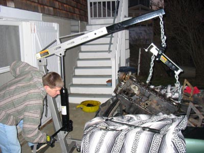

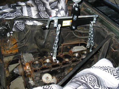

Here is how we hooked it up (keep in mind, we hooked the hoist up so we could get the tranny out too.:
