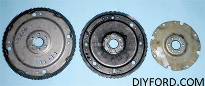

In the C4 world, they DO service mostly the 164, 157, and your 136 teeth item to the right. They don't commonly service the 160 versions found in oddball pre 1965 221/260/289 and and 148 teeth Mustang II 5.0 V8's and the conversions for V8 Bobcats, European Capris and Pintos.
"C4 flexplates exist in four basic sizes. From left to right are 164-tooth, 157- tooth, and six-cylinder. Starter drive ring gear is on the torque converter in 144/170/200-ci six-cylinder applications. Not shown is the 148-tooth flexplate for Mustang II, Pinto, and Capri applications with smaller bellhousing."
