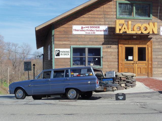

The '63 Wagon has the offset tank to drivers side with little clearance. Wagon has a later 170, Headers, T5 and original 3.50:1 rear. Currently the dual mufflers exit out in front of rear wheels and I want them over-the-axle to in back of rear wheels as trad'. the Wagon has Frame Conn's, Rear Sway bar and dual air line air shocks complicating install.
I asked a shop owner who works with classics and muscle cars and after looking underneath, said he could custom bend an over the axle configuration but would 'take some time' - ($). I don't believe there are any off-the-shelf dual exhaust over-axle configs' to accommodate the offset tank.
I doubt if you are going to buy any thing off the shelf that will work. My 67 vert had a rear sway bar but I had to loose it to install the duals on it. My tank is also off centered ,but when I actually got the pipes in I had plenty of room. I suspect you will also as the Mustangs were based on the Falcon platform I believe. You could most likely use a kit from summit for a Mustang if the sway bar were not on there.
Have you considered buying one of the kits that have a lot of different bends & pipe & try to work it over the axle& sway bar yourself ? I had to cut 1 of my pipes about 3 times to work it over the axle because it was bent incorrect.
My son in law welded it with my welder which is set up with gas shielded wire & it turned out fine.
Nice looking wagon you have.
I LOVE wagons...:love:
