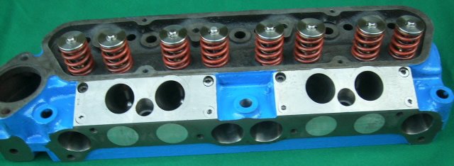

Here are a couple of pics that Wallen asked for. First, not trying to hijack the thread, but to reinforce what Paul was describing in an outside the box manner of thinking to Wallen and to show with creative thinking what can be accomplished. The top Pic shows the stock intake port with the obnoxious bolt bosses impeding air flow. The middle Pic shows after the bosses removed and the port floor filled by furnace brazing to create a short side radius, or lump as Paul mentioned. The last Pic is the 21st century solution which is a bolt-in lump that is simple to install by most any DIY-er with simple basic tools and at a much cheaper cost. However, they only mimic the street version brazed lump head that the late Kay Sissell offered, but still produces between 260-270 CFM, compared to the factory 160-ish port....

Here's what the latest technology is in Super Stock cylinder head porting. It retains the factory port volume per the NHRA rules, but flow is increased tremendously over the OEM port location and shape. You could do the same to the Ford 6 ports...

I have, sorta. I've raised the center of the entry CSA .4". So far the best I can do with out finding water. Note the bottom of the port will be raised by offsetting the intake runner~.3". This got me to 250 CFM. In the hands of a pro I believe this technique would get you close to 260. And yes I have to make an intake manifold.

The question I asked myself was how to raise the port without epoxy. After looking at port section pictures I outlined where there was material/opportunity (black lines). Additional background, with flow ball testing I noted extremely fast flow at the roof and limited flow on the floor. So I had a substantial vertical velocity gradient.
I then realized that the goal is to raise the flow column/cross sectional area as cleanly as possible. Specifically the center of the CSA. Colored lines above approximate the change in the center of the flow path CSA before/after work.
The picture below illustrates the changes in the center of the CSA at the entrance. Yellow is the original center of CSA, Blue is after widening/squaring up the port entry and green is after raising both the roof and the floor. Note the floor is raised using the intake manifold flange and not epoxy (currently). The net effect was to raise the center of the port flow area almost .5"
The next picture is the outline of my work.
Comments on the picture above,
- The second realization was that I needed a larger entry CSA. if I wasn't trying to push my peak HP to higher RPM I may not have widen the port as much as I did. I likely would have just squared it up.
-And the second point is that the horizontal line just above the floor is the approximate amount that I raised the floor.
- The port shape transitions from the outline at the entry to a more standard shape before the short turn (leaned in at the top).
- I ended up shaping the bottom to match the top. Limited impact to flow but notable impact to stability.
End results:
- An improved vertical velocity gradient, flows at the top slowed down and flows on the floor sped up.
- ~20 CFM improvement
- Rock solid stability (when implemented correctly)
