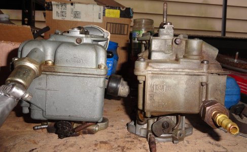

us bronk guys like it for tq as like the BBS (late evolution of carbs) it’s one of the biggest 1v. NOW...
try gettin it under the hood of the typically "low hood" '60s/’70’s fords (got 5 or 6 wrk rounds tho). I
just sawa pic of 1 - that big fat ol boy lookin ya right in the eye here somewhere... reminded me of me self gettin

I did some research on that Monojet, it is a well engineered carb. I found this which may help determine the cfm of your Monojet:
According to doug roe's rochester book 1973 printing (@ 3.0in. hg.pressure drop)
1-7/16" throttle bore with 1-7/32" venturi is 160 cfm
1-11/16" throttle bore with 1-5/16" venturi is 210 cfm
1-11/16" throttle bore with 1-1/2" venturi is 250 cfm

“...Probably not- the Rochester is 3/8” taller..."
no, that would B egg - ac - a-lee Y.
“...ask if needing the hood raised for one..."
