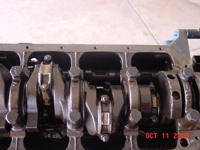

I decided to install the cam, though a couple of the bushings were a little rough--I do think that the cam will be okay. I did find some shiny metal inside the piston sleeve of the front cylinder....but I really think this cam off of the cam when we were sliding it out---like off the edge--it is very very thin and just looked like a burr or something that might have been on the factory cam. If anyone thinks I did this install wrong just let me know. I aligned the crank sprocket with 4 degrees adv. key and the cam sprocket on 0...I have not rotated the engine to try and line up the cam 0 w/ the crank 0:
Oh and--yes that is a broken bolt off the front of the engine where the cam retainer plate bolts on...I also, listed the only thing I could find on torque specs in either of my manuals---obviously it was too much. I used a grade 8 on the top and a new locking washer/aluminum and I may replace the bottom one too. I was able to put a drift punch on it and rotate it out by tapping.
