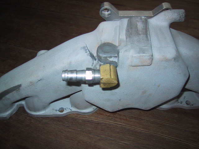

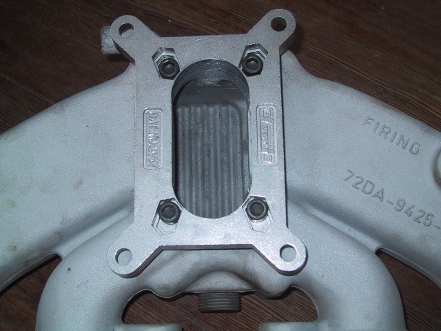

On my 3.9 dual injection (single point carb style) manifold, I cut that whole water jacket right out, then made it nice and smooth and neat.
Running a 350 holley instead of injection, and so far have noticed better performance, and no loss of power when at proper running temp.

the inlet was plugged and then epoxied. then moved to the bottom.
carb opening hogged out for the halley adapter.
