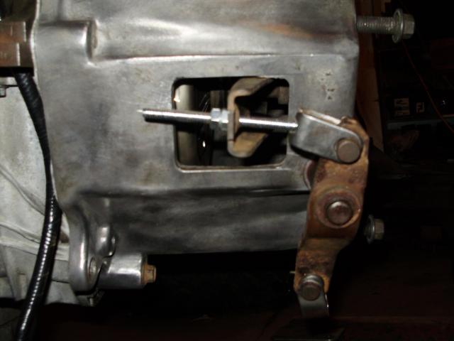

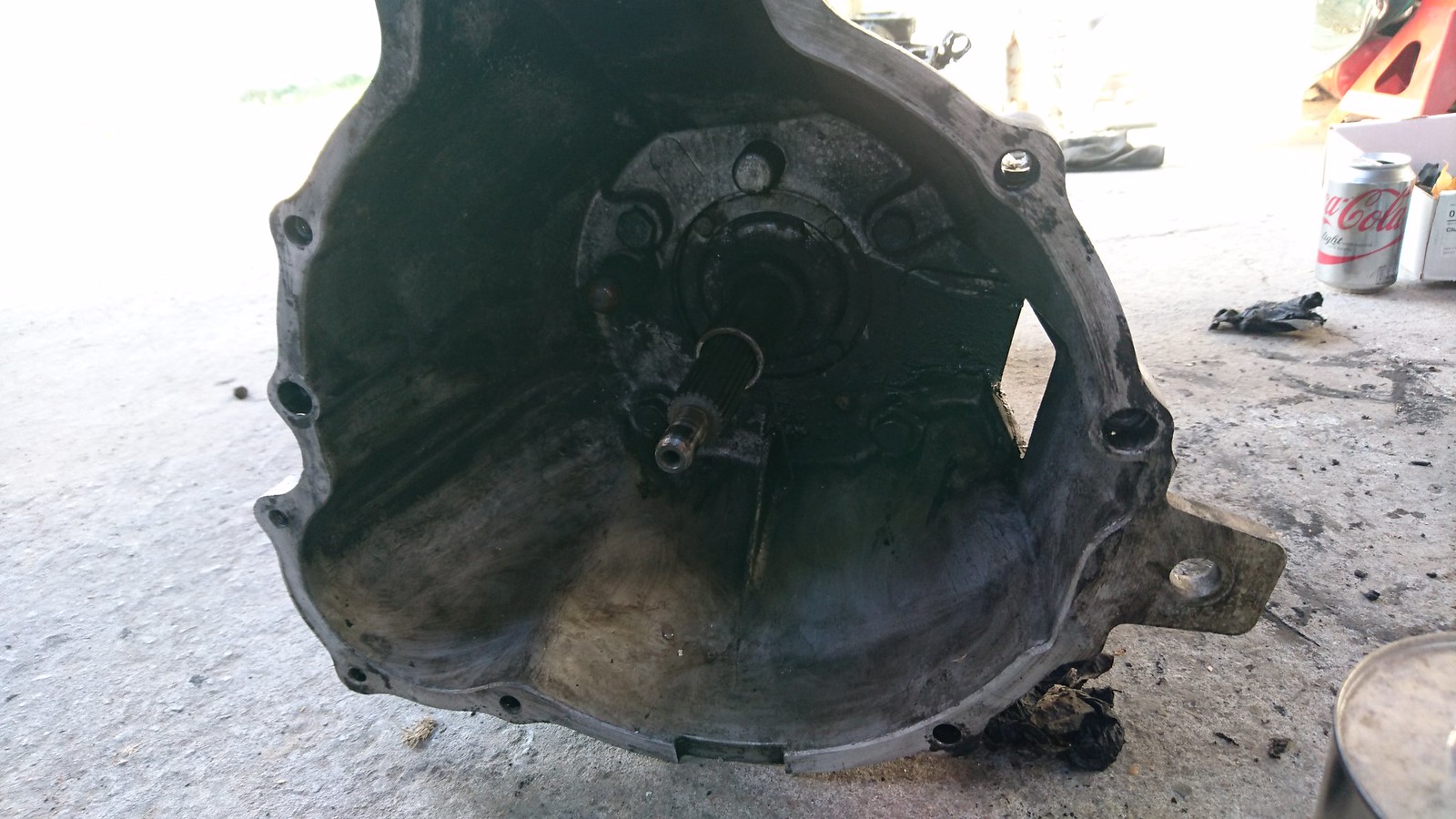

Next up the bellhousing and adapter. Can anybody label a vintage on this bell so I can figure out flywheel and clutch parts? The motor has two bell patterns in the block and the dowels are in the smaller location right now. Once I move the dowels, it appears this bell should go right on. Also gonna need to track down a block separator plate...

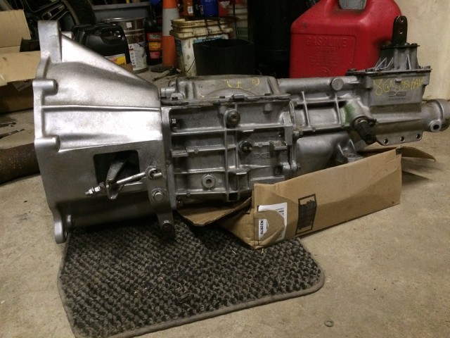

This adapter matches up to my T5's which is good, but doesn't exactly match the bellhousing. Workable though!
The counter sunk hole with no matching hole in the bell looks like I need to build up some weld on the edge to get enough material to work with. The threaded hole seems that I could drill it thru and bolt from the inside of the bell. Are these thoughts correct?
