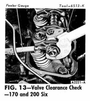

Question: what's the best way to bleed the lifters?

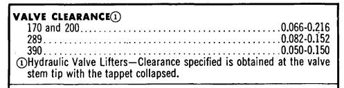

from the manual -- "Valve stem to valve rocker arm clearance should be to the specified clearance with the hydraulic lifter completely collapsed"
the special tool to do this (6513-K) seems hard to find. not worth the trouble of making one for a single use.
Should i remove the lifters, disassemble and reinstall?

from the '66 shop manual

You will find other posts relating to this with more detail if needed or you just want to. Procedure: make sure both valves are fully closed. Tighten the adjuster until all play is removed and push rod stops spinning easily between two fingers. Then tighten adjuster 1/2 to 3/4 of a turn. Done this way the lifters should be able to stay put. Prime the oil system on start up and you should be good
