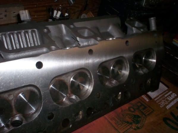

too bad he didn't start with a later big valve big port hardened valve head.imo he should have derusted the head before painting it.

The head was sent out to a local head shop to be hot tanked and rebuilt using 1.75" and 1.50 stainless valves from classicinlines shortly after the tri power was completed. guess i havent updated anything in a long time.
