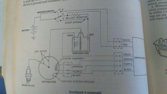

After resolving my backfire issue, I thought I'd tackle a duraspark upgrade on my 66 mustang. I purchased the performance distributor module (blue duraspark), inferno coil, and a re-curved dizzy from wsa11. I have everything installed per the wiring diagram below with also the brown wire removed on the starter solenoid and no ignition fire at all. I had 6v to the coil with the ballast resistor in. With the ballast resistor bypassed and 12v to the coil still no fire. I have a good ground on the black wire from the distributor.
Resistance between the purple and orange wire varies from 4.7 Mohms to 597 ohms as the engine is cranked.
I plan on checking the ground quality of the module case later today, if the distributor ground wire has a good ground...is the module case ground important too?
What else do I need to check?
Wiring diagram:
http://i163.photobucket.com/albums/t281 ... ooxymg.png
I've got my own issue with my setup, so definitely not an expert, but I think I can say that if you are using a motorcraft type blue grommet module that the diagram in that link is not the right one.
This is the oem diagram:
Here's one from painless wiring:
Duraspark-Wiring-Diagram-The-Proprietary-Painless-Solution-Is-What-You-Want-To-Create-Something-That-You.jpg
Here's another one that's pretty good:

I have the dynamod module in the wiring diagram I posted.

Figured it out. I had the negative wire and the ground wire from the distributor crossed. Also I had the index way off on the distributor. Had to turn it near 90 deg. to fire.
Great, cause the ohm readings on the Duraspark pickup are 400-800 ohms. Get it timed & get her rolling.
Econo's schematics R 4 a different module. His is Ford oem.
Yours is "Performance" a different manufacturer…
(So R some of ur other components).
