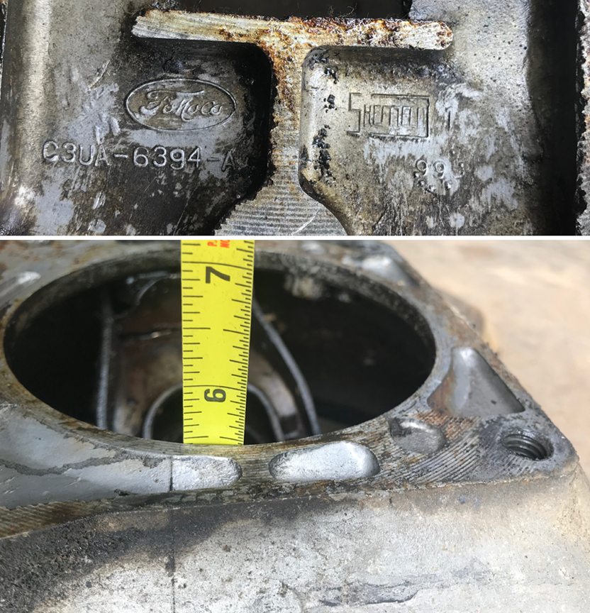

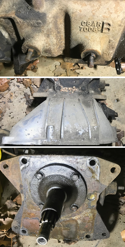

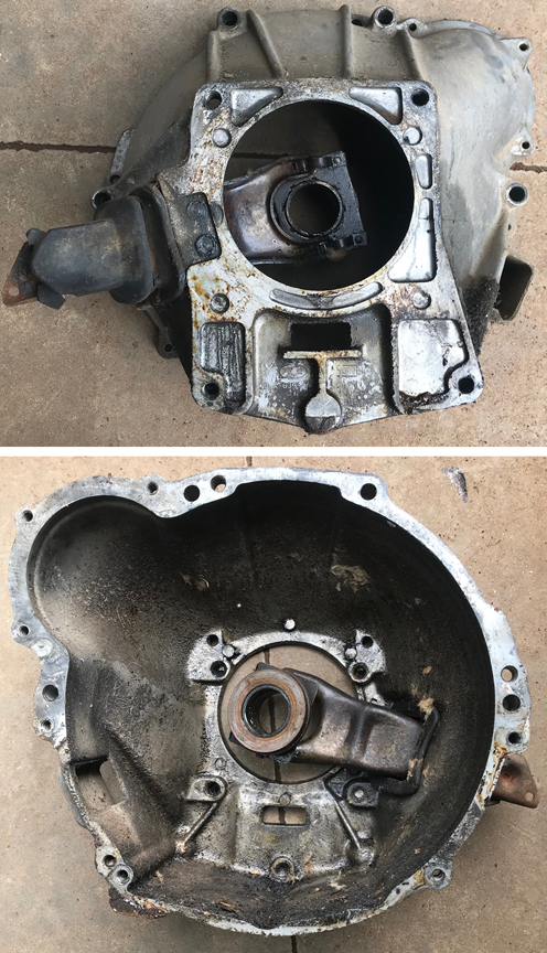

Ok I decided to take one for the team and disassembled the bell and transmission from the 170, there was a big old rat nest inside the bell anyway :roll: Have to look this bell up now that I have a number or someone may know, remember I picked this up off the ground so I have no idea what it came out of but it has a '63 part number.
Looks like it is around 5 1/2" deep.
The transmission I know came out of an Econoline van and has a '68 part number code, it is dual mount pattern but I really don't know if they are all that way (3.03) I do know this transmission has a shorter input shaft than a '72 Maverick :roll: and you cannot swap the input shaft into the Maverick transmission and I ended up putting the tail shaft and housing off the Maverick onto the van trans (that worked, I know I am repeating here from my earlier post).
Also lying around someplace I have one of the cast iron bell housings it may have come off the van trans and I think the Maverick bell, if I can dig them out I will get numbers and measurements and post some picts, BTW neither of them worked on the 170 I think they might be big pattern on the engine block side.
Also, but I don't know where it is I have a Maverick 3.03 with a van tail shaft :roll:
EDIT: As I think back there seemed to be an issue with the diameter of the bearing retainer on the transmissions and some would not fit into the center hole of the bell.

Did a quick Google search, the C3UA-6394-A is for a '63-'66 Econoline with a 170.
The C8AR-7008-B (I can't find a "B" reference) 68 top loader casting used '68-'71.
Makes sense I guess that they would fit together, I guess I would have to have the tag know all the skinny and I don't.

Thank you Mike, the Econoline bell housing casting number info is the biggest piece of the puzzle for this combo. :thumbup: :nod:
