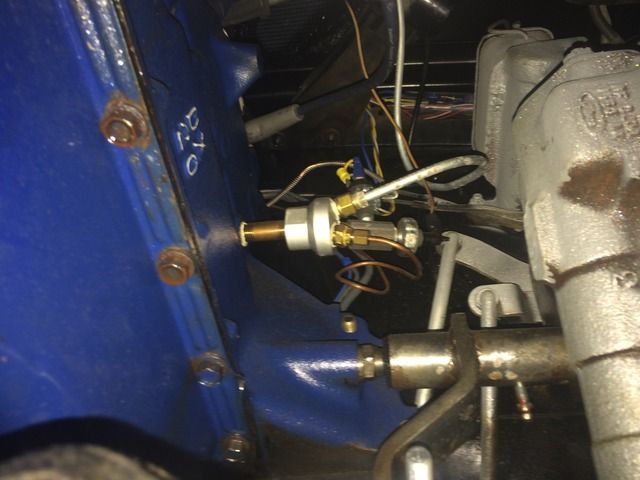

... only if installed without regard to standard safety practices. For safety, electric pump systems should incorporate at least an oil pressure switched power source ( with ign,/start bypass) in case of a fault/leak in fuel supply. Factory setups typically also include a rollover valve for worst case scenarios ...
https://www.summitracing.com/search?Sor ... y%20switch
(250 oil pressure port tapped for FP safety oil pressure/Ign bypass switch, SC oil line feed, original lamp switch and NHRA compliant metallic cabin oil pressure gauge line.)
