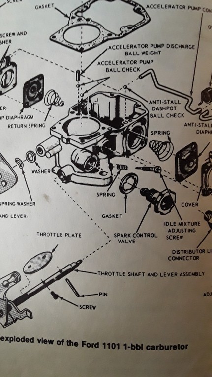

Something else I just remembered is that I had four check balls in this carb. I just now saw an exploded diagram of a non-spark control carb and it had 3 check balls. I wonder if this carb had been rebuilt before but incorrectly? If you don't have a spark control valve carb do you not use a check ball in the spark control area?
no, U use them, a 'weight' too, I believe.

The Blow up diagram of the 1101 in my Chilton shows 3 check balls and the weight. But also shows an scv so take that as you will.
When I got my van it ran horribly. When I rebuilt the carb I found it was missing a check ball and had a check ball in place of the weight( 2 check balls there. This was a Canadian rebuilt Autoline carb that I know the previous owner never opened up. He's friend of mine and not mechanically inclined. I asked him about it to. I made the weight per Mike's carbs instructions and rebuilt the carb and it ran pretty good. Like night and day compared to before.
