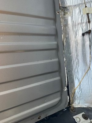

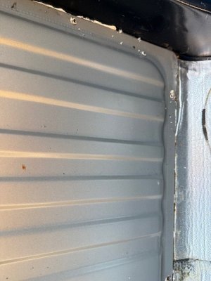

Hello of of you that have supported my effort. I decided to play it safe and remove the fuel tank to ensure that is clean.. Reason is that after I tune the cat with the existing Autolite carb I will be installing a tri power Offenhauser so I want to make sure that the tree carbs will be free of debris from the tank. Easier said than done. Whoever installed the tank in 2020 the y used, I Think PVC cement and the tank is stuck and cemented in the frame of the car where the tank goes. I am using Isopropyl alcohol to see if I can soften the joints and pull the tank away. If this becomes a real issue then I am planning to replace the sender unit and in that hole see is if I can clean any garbage that was left behind after draining the tank.
Can any of you recommend anything with regard to the removal of the tank?

I tend to agree. Piano wire or a guitar string will be about the best way to cut a silicone bonded tank free.

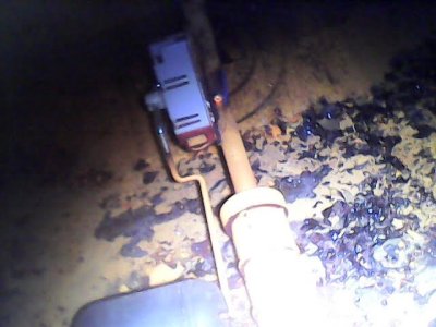

Thank you. The tank has been drained of all of the fuel six days back and it is all dried. Is it safe to apply heat with a heat gun to the edges of the tank to soften the seals where it sits in the car's frame? I was able to partially introduce a borescope an take pictures as shown. Tank is pretty dirty and it seems that is from the fuel. So I have to have it cleaned. Please your comments regarding the heat gun application

Tank looks really bad for as "new" as it is. . . Just helped a friend get his big generator going. Carb was all gummed up. . Alcohol in gas is ok for daily use, but when it sits its destructive in many ways.
Be overly careful with heat of any kind. Don't make a spark either when it comes loose. . I've seen guys fill the tank with water. This flushes all the vapor out. The weight may help it break loose when you start releasing the silicone too. Not a recommendation per se, just info.
How is your aversion to risk? Sometimes an empty gas tank is more dangerous than a full one.
Since this is a Mustang, here's what I would try: if you have a floor jack, place a piece of plywood on the jack saddle and with the tank's bolts out, put some upward pressure on the tank. Don't cave it in, just a little upward pressure. Then try to cut the sealer and pry the tank up and out.
It looks pretty bad inside to me and with the availability of aftermarket sources of new tanks I don't think I would spend a lot of time on it.
An empty tank with some vapour is quite volatile. I like Otto’s suggestion of a jack and plywood. I’d fill it with water and follow that suggestion.
Remember the mustang tank is removed up and out of the trunk- it doesn’t come out the bottom.
A jack would be helpful as well as someone to keep pressure on the tank- keep jacking pressure on it.
With a little care, you should have no worries from the vapor inside. No spark risk on the inside. Nothing is moving on the inside to generate a spark. The tank is sealed, not leaking. Maybe don’t put the jack in the middle to start. Start on one corner and get it broke loose. Once that happens you on on the down hill👍👍.

Thank you all for your suggestions. As Otto indicated I placed a 2x4 under the bottom of the tank and with a hydraulic jack I placed some upward pressure on it. I then with a syringe I spread acetone to all of the edges and two hours later the tank was released from the sealant. Tank is out and I will be taking it for cleaning. Again thank to you for your interest in helping me out. Regards
