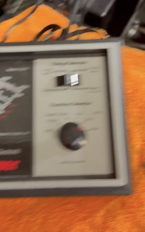

I noticed in the video you switched the top switch, which according to the bottom switch I looks like you are in the tach mode. So you are switching from the 6k range to the 12k range. You need to have the bottom switch in the points/dwell position and then switch the top one between points and dwell.
I may be wrong on this, it just a glimpse in the video. Just checking and assuming you are showing the dwell reading
I am going by this clip of the video. It looks like the meter is set at the 6cyl rpm setting
Dear Members, I would like to thank all of you for sharing your knowledge and experiences with this newby. As you indicated Don I had the button of the instrument in the wrong position and I was dumbfounded that I coud not get a steady dwell reading with increased RPM. So this Pm I went and checked carefully and did find that at all times the button was in the wrong place, thereby the dwell is nor steady at 40 deg. Thanks for the suggestion.

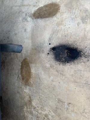

Opened the carb once more and checked the float level. Found it to be at 1 inch from the flange of the top of the carb. Releveled at 1 1/32 in. Put it back and started the car. when cold the car starts but with a very rumbling idle util it starts to wram. THen it runs smoothly at 800 RPM. I need to go back and recalibarte the fast idle speed to 1200 RPM. However, the car continues to run rich at idling. (Refer to the picture). I am pulling my hairs. I have done and adjusted this carb so many times that I do not know what else to do.
At least now starts and keeps idling
Just so you know, some of that coming out of the tail pipe is normal. Especially if the car has just been started and run for a short while - never really heating up the exhaust. Condensation is a byproduct of combustion and it will consolidate in the pipe. It will spit some of it out at idle. It will be black too.
I’m not saying you don’t have a problem, just don’t go by that alone. If it is running good, depending on how cold your weather is, I would run it for 1/2 to 1 hr. ( like you stole it😎). Get it good and hot.
Stop, check the plugs, then start it again and see if you get the same discharge at the tailpipe
What @DON posted is accurate to my experience as well. Especially this time of year, every time I fire up my car, condensation will drip from my pipes and sometimes some soot will come out in the watery debris. Primarily it's because I drive it, get everything hot and then it sits and cools in a humid environment.
I am very encouraged that you've got the idle smooth. Mine isn't particularly happy when it's cold but smooths right out when it's warm and that's with a lumpy-ish camshaft. That's just the nature of these beasts, especially on the gas we run today.
The shop manual won't help assess how a mid-60's carburetor works on 2026 fuel blends. It's a starting point and then you either live with the best you can do or you can dial it in with an AFR gauge. I'd get out and drive it and tweak it as needed.
Get out there and drive it. Take it for a good long run and then reassess where you're at.

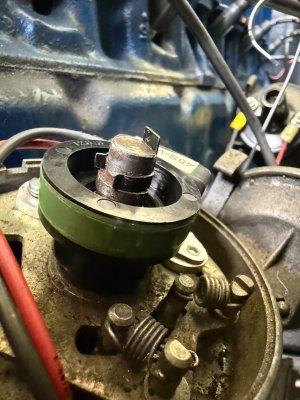

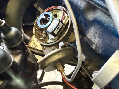

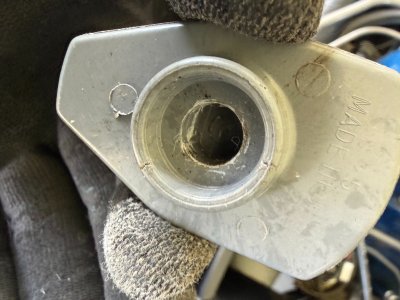

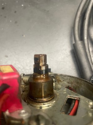

Hi, I am adding to this thread because I am in the middle of solving a no start problem on a 1966 Mustang 6 Cyl 200cu.
I have been following this thread and it helped get me to this point. I can now start the car, but it ran rough. Then I got carb rebuilt.
Before starting again, I learned I was missing this little distributor 'clip' that goes on the distributor shaft. This clip cost $10 from a parts supplier. When installed today, it appears to 'stick up' and keep the rotor from going down far enough.
When installed like the picture, the Distributor cap will not go on because the rotor is too high. It hits the cap and won't clip in place.
I tried to put the clip the other way around, with the tab down. But when I try to do that, the rotor hole won't go over the tabs pre bent in the clip. So from these experts, Which way should the distributor clip be installed? Flat part up or down? Thanks,
Pic 1 is the closest to being correct, you just need to install it below the raised area on the shaft👍
