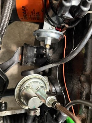

Thank you Frank for your comments. As I was trying to get the crank to be at the 12 deg position, I started to trurn the distributor that was on TDC (point gap was open) i checked and found that the points are grounded, meaning the test light that I connected to the neg side of the coil the light remained lit. Point gap open light should be off.
Appreciate all the assistance.
