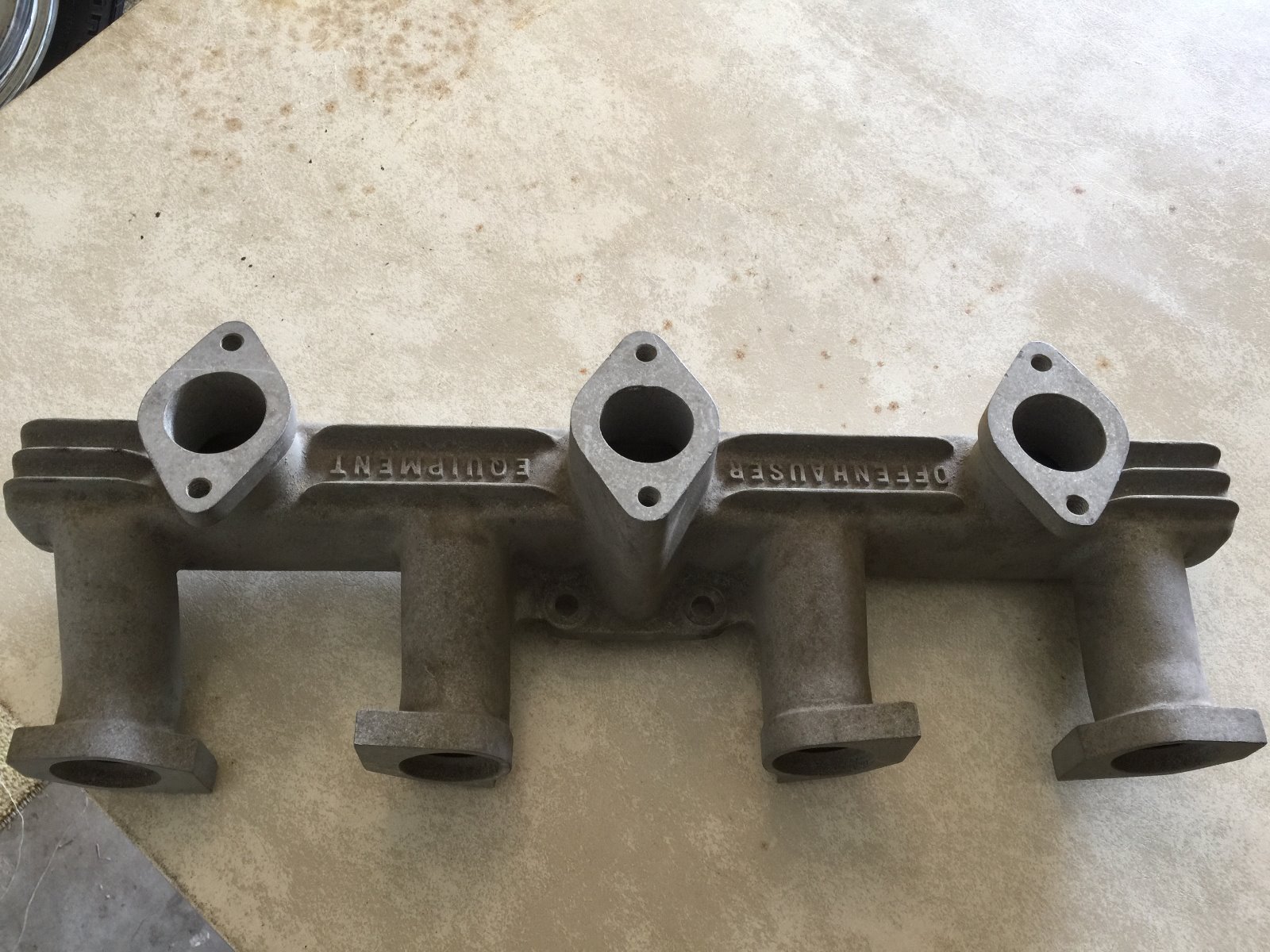

Would a 2 x 1 or 3 x 1 Offy intake manifold perform better than the Clifford single Webber setup?
Im no professional when it comes to performance, but I am an auto technician by trade and it seems to me that a single carb intake manifold wont balance out very well on the cylinders. I would expect a dual carb or triple carb manifold to perform better because it doesn't have a longer distance to fuel the outter cylinders than the inner cylinders. I am also a fan of the more traditional look (or period correctness) of the Offy manifold with 2 or 3 single barrels.

The Clifford intake is a very good one (Ram Flow design) this improves the fuel distribution over the log type design. It should also have the ability by the changing the carb adapter plate to bolt on a 4 barrel Holley as well as others this would give better performance over your Weber. So to answer your first question the Cliford intake performs better then all the others, they also made a duel carb intake too, these when setup with a pair of 2 barrel carb's like your Weber it would also perform very well.
The 2 X 1V offy's and many others brands used in the past (Fenton, etc.) all perform quite well, and when matched against the original intake where a huge improvement even giving better fuel economy. So in answer to your other question yes with these early log style intakes a 2 or 3 X 1V carb intake dose give better fuel distribution when compared to a stock intake setup. I also like the looks of these traditional setups using the Holley 1904 carb's with glass bowls. Hope that answers some of your questions good luck :nod:

IMHO,you just can't beat a 3 x 1 intake with small single barrel carbs on a street inline 6. It will give the most power as well as the best gas mileage.
