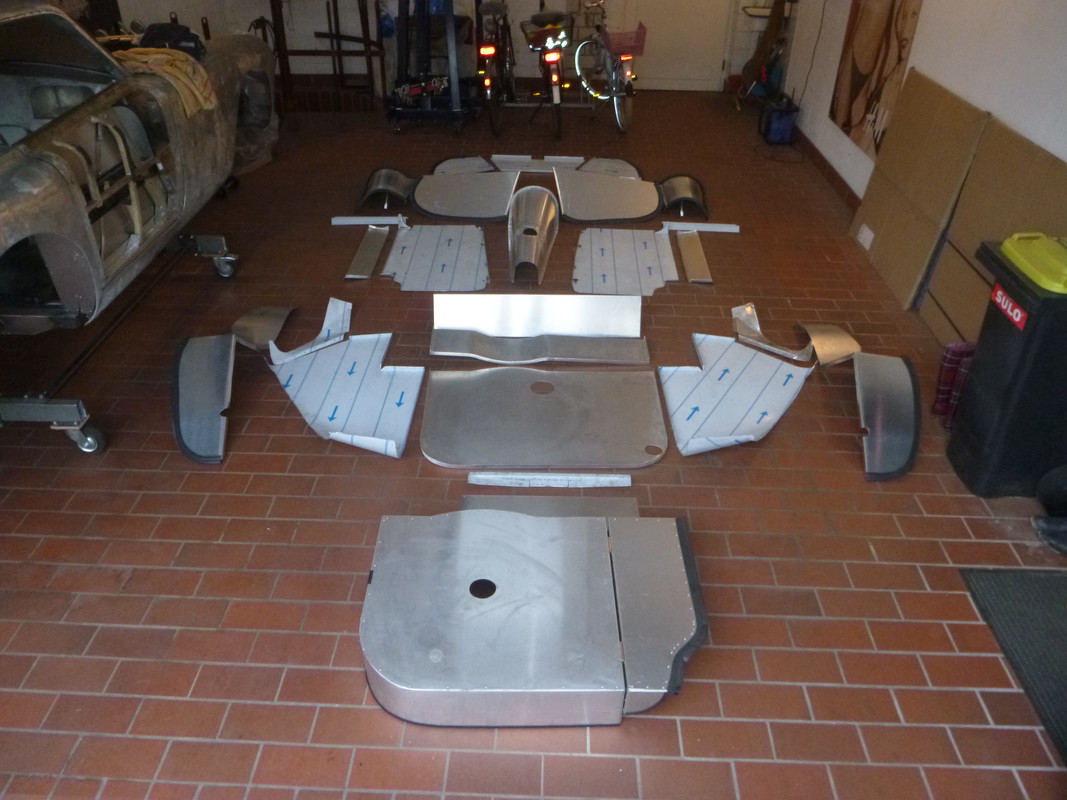

dkp, your work is sensational.
BE646 is in as good hands as AK 1029 was! You full rebuild of both the tube frame, ash wood and aluminum pannelling is exceptional.
Man this could go anywhere!

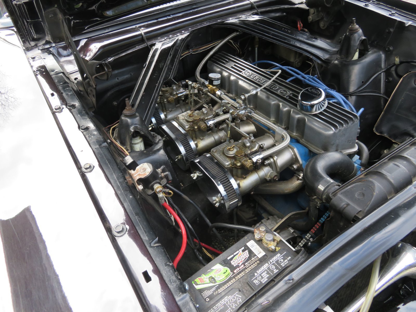

HI Peter, I have experience with the 215, 223, & 262's six family, 144, 170, 200, & 250 six family, as well as the 240 & 300 big Ford sixes. Don't know much about the Bristal or Zepher six'es I doubt that very many ever made it over here to the US. While stationed in Germany (1971-72) I do rember seeing some the German Fords car models late 1950's to late 1960's Taurus?, think they had inline 4's and V6's though. I imagine the older straight six cyclinder engines are getting quite hard find over there now days.
From looking at pictures of your restoration (excellent workmanship your doing) the English Coupe appears to be a light weight car in about the 1800 to 2200 pound range. As Xctesy stated the 223 is a heavier engine I don't remember their true weight but I think it's right at about 485 to 500 pounds complete, the 200 is one of the lightest six'es if not the lightest of all the sixes at 385 pounds compleate. There isn't much of a problem getting either of these engines up into a 140 to 150 Hp tune, just a matter of choosing the right parts and careful assembly technic's, and in any case at that power level it should make a very nice fun Road car for cruseing on the Autobahn. Once you decide on the engine you want to use it will be easy to come up with a build plan to attain your HP goals.
The 215 version of these Ford sixes were first used in the 1952 Big Ford cars and Pickups starting in September 1951, the 223 first came out in the 1954 models. The 262 was first used in the big Ford trucks in 1961. I have tuned these stock engines to idle down smoothly as low as 385 to 400 rpm, stock they also have great low RPM pulling torque. Stock rebuild parts availability is still quite good as they are popular pick up truck engines used until 1964 and in many industrial applications until 1965. Speed equipment is also still being made for these engines by a few companies too. There isn't much you can do to reduce their weight though. It's easy to bolt up your top loader trans to them. As a side note I got to go with my Dad when he went to our local Ford dealer to order a new 1956 F100 pickup (223 six with a 3 speed trans). Later I learned to drive in that pickup and also raced it at the local drag strip, these old 223 engines hold a special place with me.
The 144 small Ford six was first used in the 1960 Ford Falcon starting in September 1959, 1961 the 170 was available, and the first 200's were used mid year (about February) in the 1963 and 1/2 model Ford Fairlanes (this was during the roll out of Fords "Total Performance Program"). The 200 is a great little engine with lots of potential, externally there isn't much differance visually between a 144, 170, or 200. Yes the log intake on the orginal heads are not ideal but there is a number of ways this can be overcome to still get excellent performance, such as using three 1V Carb's or one two or three 2V carb's, Webers ect. They are stil very popular with lots more in stock parts support and a huge amount of speed equipment available even including an great Aluminun head and many intake choices. A stock 200 has very good pulling torque from a low RPM too. It's easy to bolt up to your top loader Trans. It's also possable to shed a few more pounds of weight with some of the available parts such as an alum. water pump, small Alternator's, the above alum head, ect. My plan is to build a 170 six for a light weight drag race / street car using all these available techniques that is if my budget will allow (it's going to be a very small). Even with a cast iron head the total wight could be reduced to about 360 to 350 pounds.
Is there any rules that you need to follow with your Ralley car build, or does it only need to appear as a vintage year engine? Of the two engines the 200 to me seams like the best choice for your light weight of car.
Lastly there is the 240 & 300's six'es they were first used in the 1965 model big Ford cars (240's only) and both in the Ford trucks visually they look the same externally. These Ford sixes weight in at around what a SBF (small block Ford) V8 289 / 302 weighs about 485 pounds compleate they have great torque too. Stock rebuild Parts are also easy to find and there are severial companies that make speed equipment. A hybrid Alum head is being built currently also, cost should be reasonable. They used the same bell housing pattern as the SBF so easy to bolt up to your top loader trans too. Stock these engines are in your above stated HP requirements so that it's easy to get way over 150 Hp. Below is a link of a site members Triumph TR4 sports car build up that's using a 300 six. viewtopic.php?f=2&t=73522

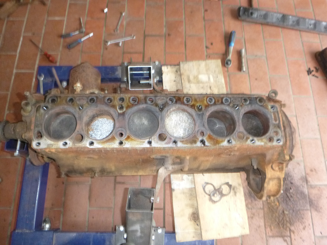

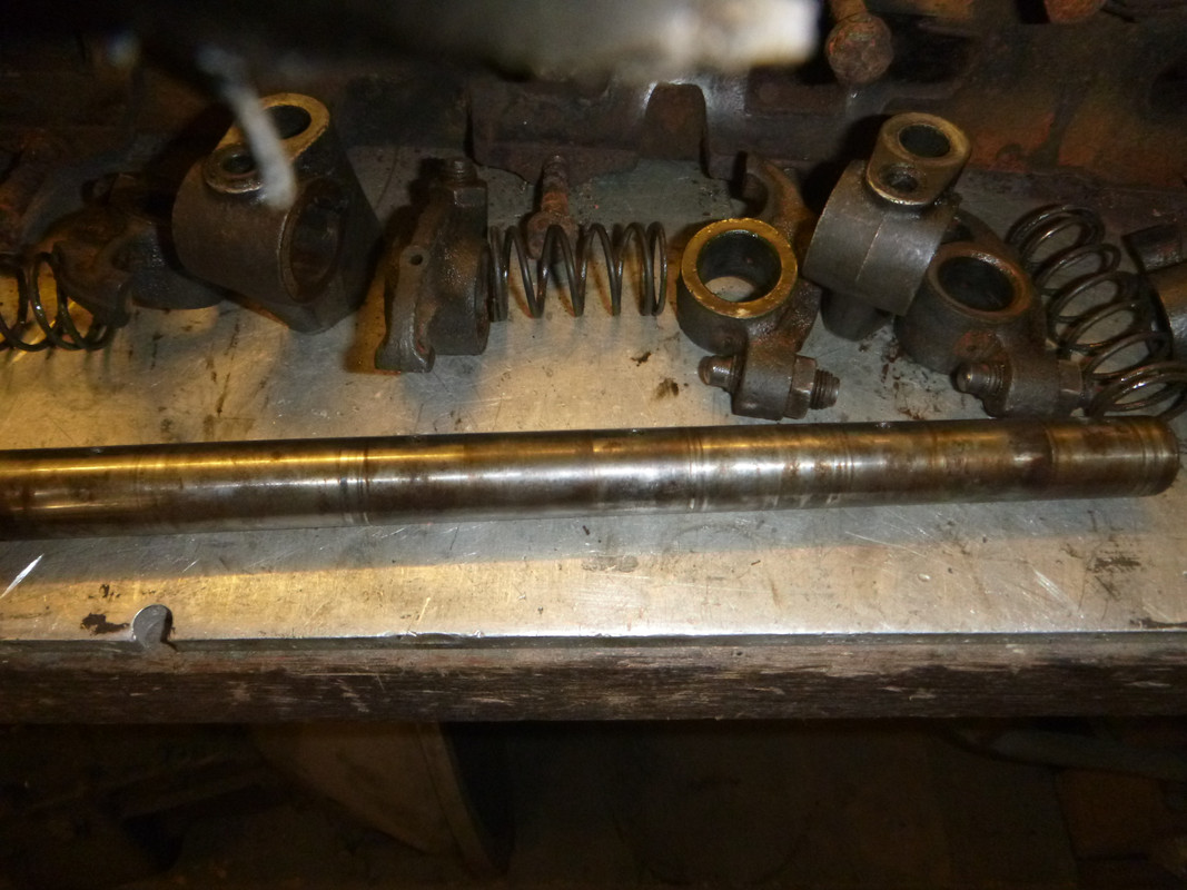

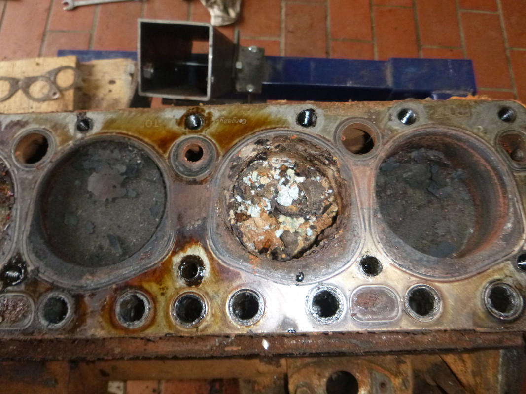

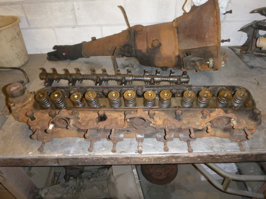

thank you for your input. In the meantime I was able to buy a Ford Zephyr MK II engine (206E) here in Germany. The engine didn't turn because all pistons were stucked.
I could remove them but one piston made so much problems that the cylinder sleeve also came out.
In order to rebuild the engine I need a lot of spare parts. Do you have any advice were I can buy pistons and bearings for that engine?
Kind regards,
Peter

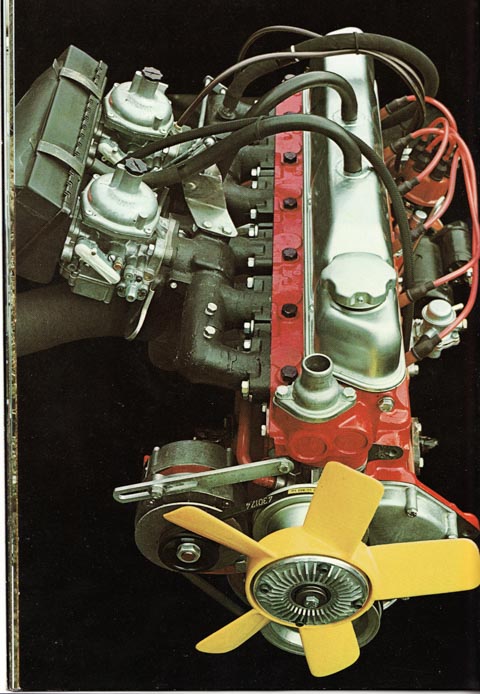

:beer: That's a great score, congrats on finding a Ford Zephyr Mark II 2.6L Six engine! Looks like this first Company (the top link) carries all the stock Ford Zephyr Mark II engine rebuild parts. Second link shows lots of Company's dealing in Ford pats in many different Countries. Third link lists some performance parts such as ARP bolts and Valve covers, and a few other parts for the Mark II engines. Hopefully there are some links that are of help to you. I didn't get to work on or rebuild any of these Zephyr six'es so haven't personally bought parts from any of these listed companies. Good luck in the hunt. :thumbup: :nod: Edited to add some additional sources

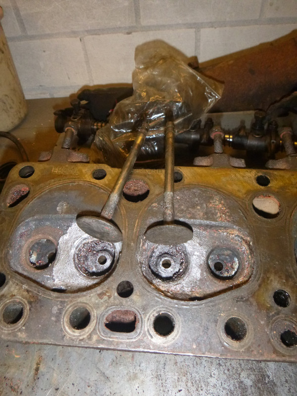

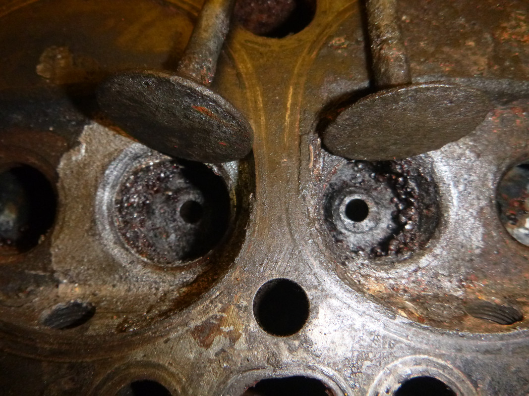

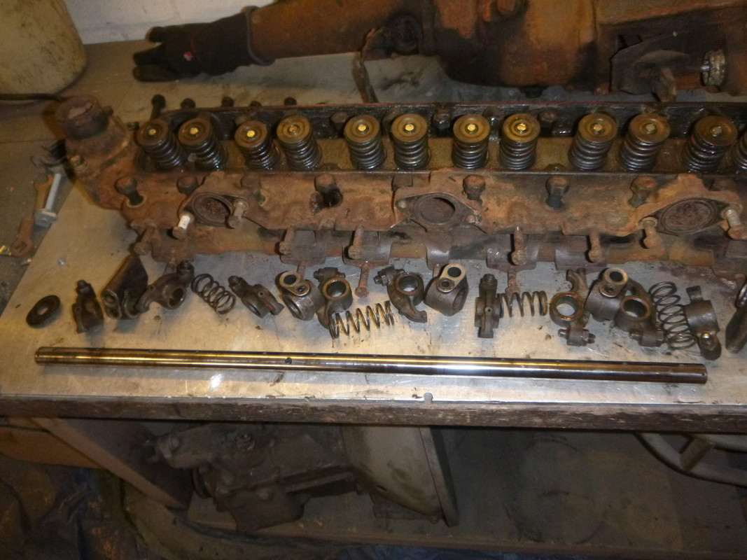

Thank you for the links. In the meantime I disassembled the head. Two valves were heavily stucked.

Post #11 by xctasy » Thu Sep 13, 2018 4:01 am
:mrgreen: :thumbup: :cool: :hmmm:
:UK:
Its almost Oktoberfest. :Germany: :P The engine needs to be Quarantined and Cleaned, LOL.
Grab a big spa pool, and soak that engine in beer or Coca Cola.
Worked for me....
