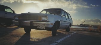

Post #14 by Derangedfords90 » Sun Jan 08, 2017 1:54 am
Pics of the car. It's ugly and I love it.... also I forgot to mention, the AC still works. That was my goal. Now to get it fine tuned.
