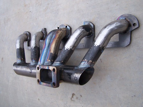

Here is a one flange I made for my 223 turbo header, but the 3 & 4 exh port need a divider. So I made another one. its 1/2" mild steel with sch.10 runners.
Some tIG welding and grinding.
Final Product.
This is a long term project so I have not got it out on the road, but it sounds awsome.
