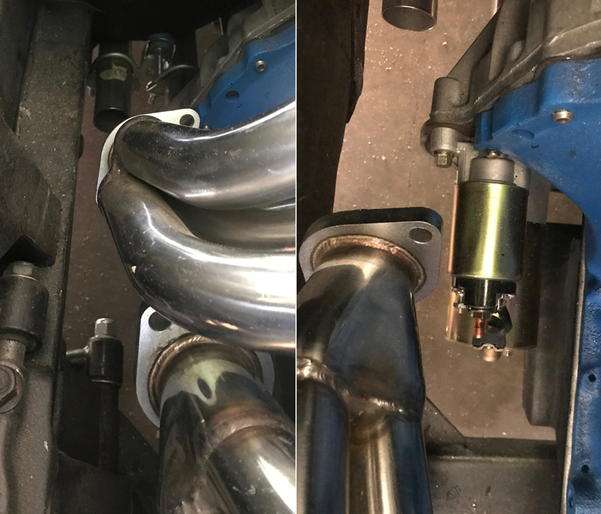

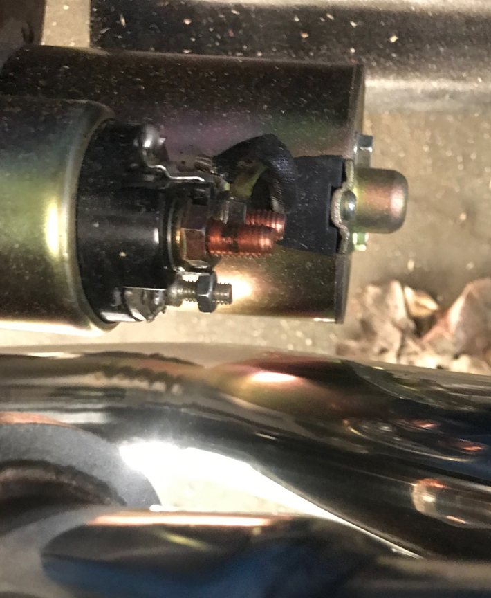

Your problem starts way before the collector. In the above pics, you have several inches of clearance between the frame and tubes before the collectors come together. If the primary tubes weren't bent out of the header flange so sharp, then the collector would have more clearance around the starter.
I totally agree with that, the problem is the header is not made for a 250 (or a low mount starter 200, I would guess) I am going to use the stainless header but need to come up with a solution that is more elegant than what I subjected this header too :roll:

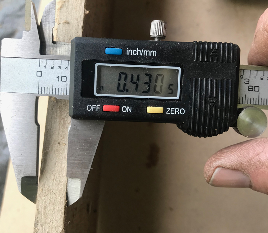

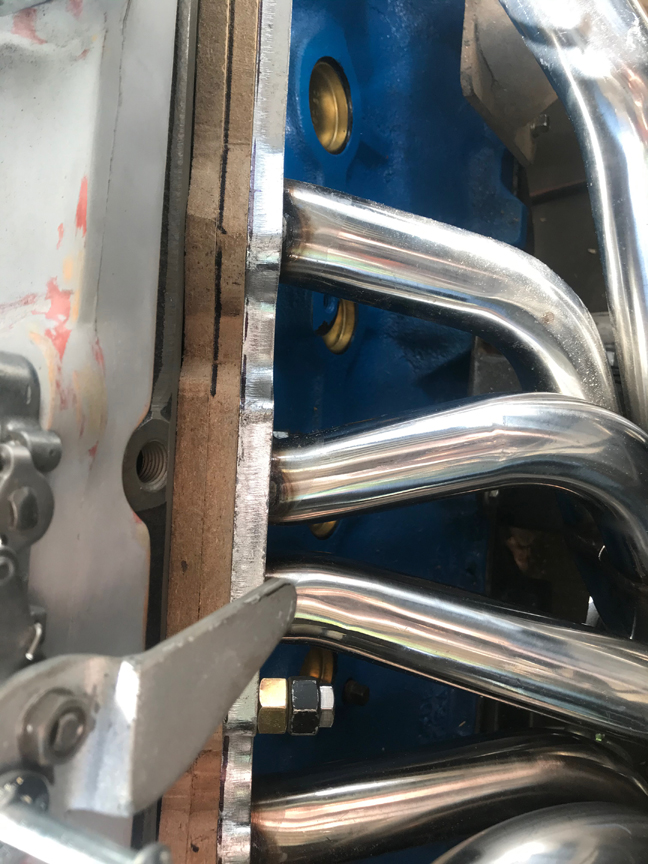

I made a spacer out of some masonite I had laying around, it is right around 7/16" thick.
Snugged the bolts up firm, it would sit out a bit more with two gaskets on there but I think I could still benefit if the spacer was 1/2" thick.
I bolted the A/C - Altenator bracket on there, certainly a York compressor won't fit but I could make an adapter for a Sanden compressor, I think there is a compact unit, if I am not mistaken, there is a conversion bracket for this but it looks like a piece of angle iron to me with some holes drilled in it.
A lot more room for the starter and still plenty of room on the frame side.

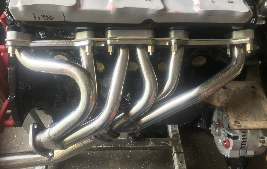

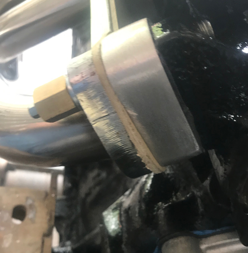

Ok like I said earlier I went ahead and stacked two masonite spacers in there to bring the total thickness up to 3/4"
Gave good spacing on both the frame and the starter. You could actually unbolt the starter without taking off the header.

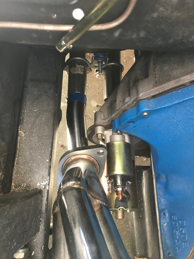

I trimmed off the original upper downpipe and mocked it up on the lower pipe, looks like it was meant to be there, A little close to the bell housing but it doesn't touch and I may still trim the bell housing down right there to match the engine plate. The pipe just needs a little grinding on the end for some clearance and a band clamp added

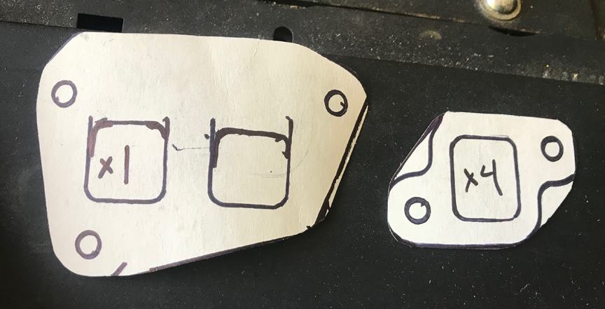

I made these patterns for the spacers, yes the smaller one works on 1-2-5-6 by just flipping it over, it could be made out of 2"X3/4"X3 1/4" long bar stock. The larger one you would need a piece od 3.5"x3/4"X5" long bar stock.
I am going to try and order some aluminum and try and fabricate the spacers.
The only other thing I need to do is make a pattern for the other downpipe and see if someone can bend it out of the other pipe but may need to have the flange end cut off and re-welded closer to a 45. (it needs 3 bends in it approx. 45 degrees, I think I can make a pattern out of 1 1/2" PVC pipe fittings.

What do you guys think of studs for the header install instead of bolts, is there an issue using them? I thought it might be easier to stack the gaskets and spacers on there with studs sticking out instead of trying to thread bolts through the stack.

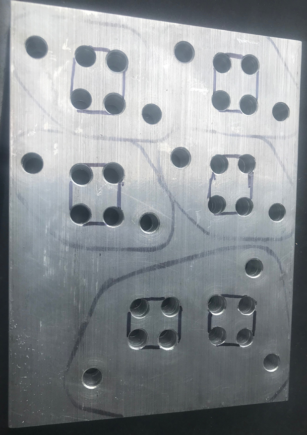

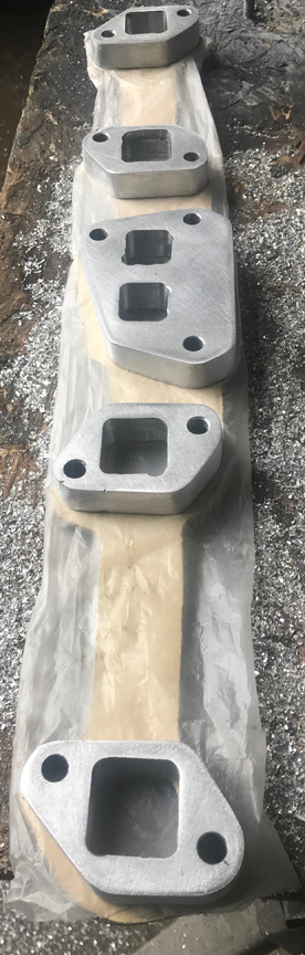

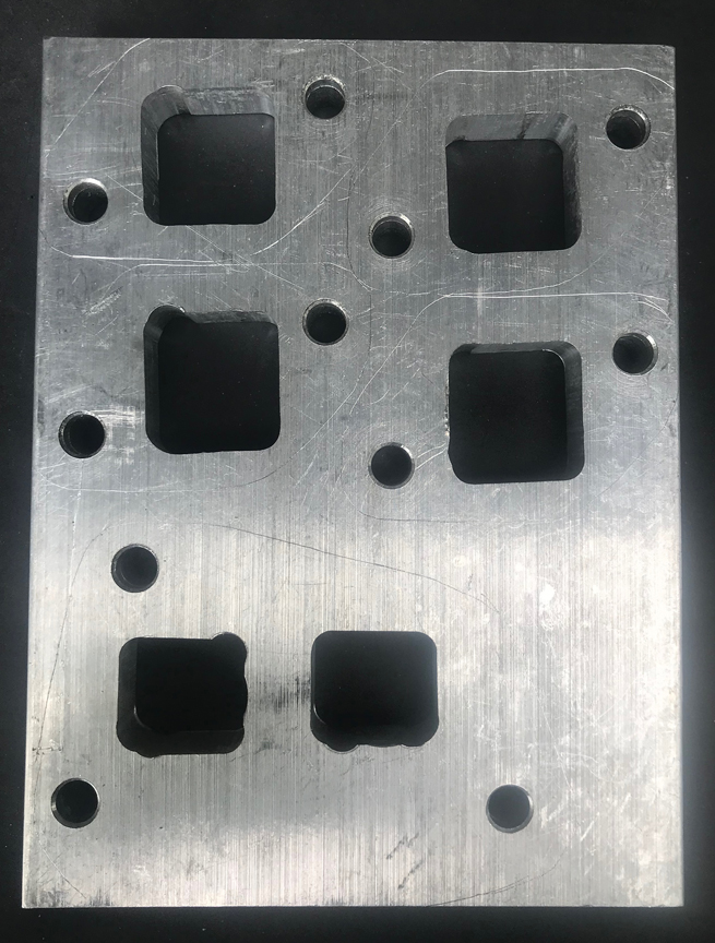

Ok I know you were all waiting to see these (maybe not) I made some spacers out of 3/4" aluminum.
I bought a chunk of aluminum 3/4"x6"x8" ($23 from Amazon, I know you can get cheaper), I laid everything out and drilled all the holes before I cut anything out.
Then I made my holes square, I know I have some bobbles but I was doing this all by hand, if I was to do it again they would be neater because I figured out how to do it as I went.
Finally I cut them to size and cleaned them up.
I used a stock gasket and cut it apart to put behind the spacers, I am going to change it out to the one that came with the header because the center port holes are too tall on the stock one, I think the other will make a better seal.
They look pretty good all things considered.

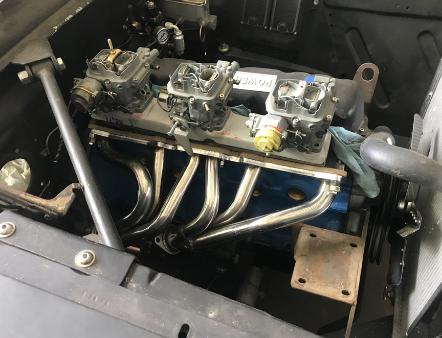

I used some 3 1/8" studs to mount them, only the top nut of cylinder 3 needs put on before the header is fully tightened down, probably a regular nut would go on instead of the long brass ones but I guess I will leave the brass, I also used anti-seize on the studs where they screw into the head.
I hope that helps someone who is doing a 250 header install (or a low mount starter 200), not the only way to do it but how I chose too.
