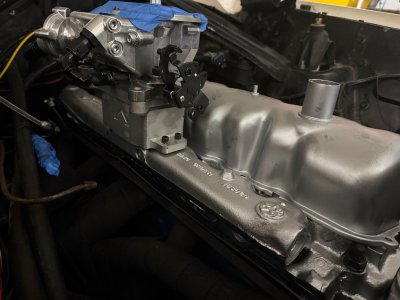

Configurations 1 and 2 were very similar, with no statistically meaningful horsepower difference. However, the Sniper completely solved my vapor lock issues and makes cold starts effortless, even after sitting for weeks. I would recommend the Sniper 2300 for drivability, though it does lose a bit of the 1960s charm.
My only complaint about the EFI is that the touchscreen is somewhat sensitive and tends to jump around due to dust and debris. My Falcon is a convertible, so it is exposed.

I am very happy with the conversion.

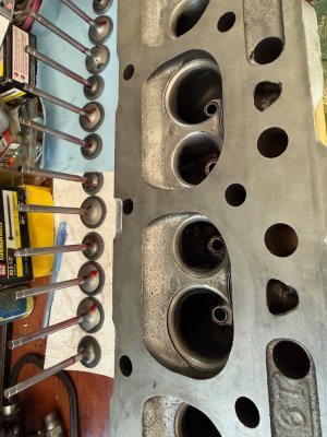

Other notes: Compression and leak down tests before the top-end rebuild were adequate so I did not resurface the valves, head, or block. I did replace the valves, head bolts, thermostat, and leaking valve seals, but not the keepers or springs. I performed a mild polishing of the ports. I power washed and glass bead blasted the head rather than a more appropriate and typical approach.

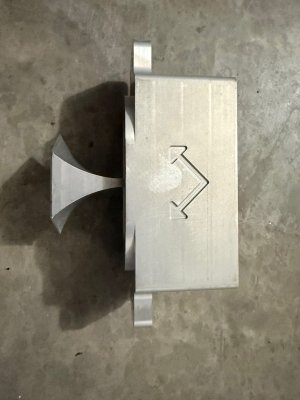

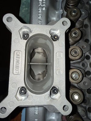

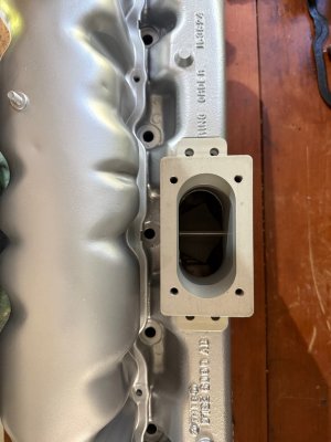

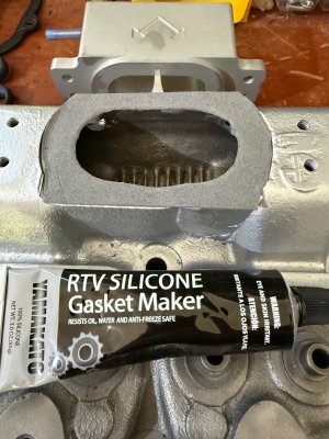

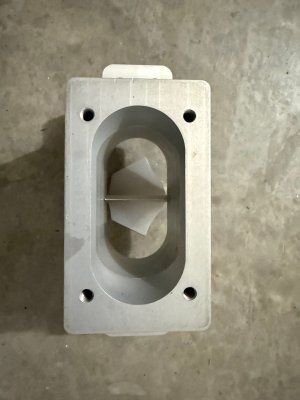

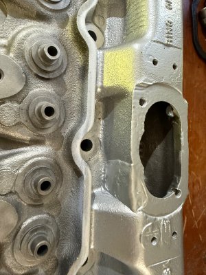

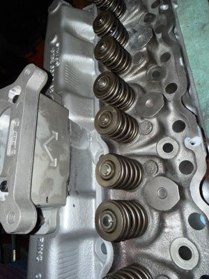

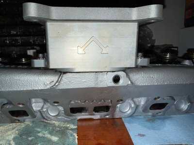

I machined the log head as shown and used a little JBWeld to backfill the driver side rear of the racetrack machined surface. There was ~1-2 mm of solid material left, but I wanted more for the gasket. I sealed the gasket only to the head side. The four hex bolts used to secure the divider were measured and spaced appropriately so they do not interfere with the gas flow. The divider is removable from the box and is angled about 15 degs off perpendicular to direct some gas flow to the first adjacent intake runners.
And for fun, I machined part of the symbol for entropy onto the box, symbolizing "Control Entropy".

I do not think that that gasket maker is rated for gasoline/alcohol, but I could be wrong. keep an eye open any leaks down the road.
