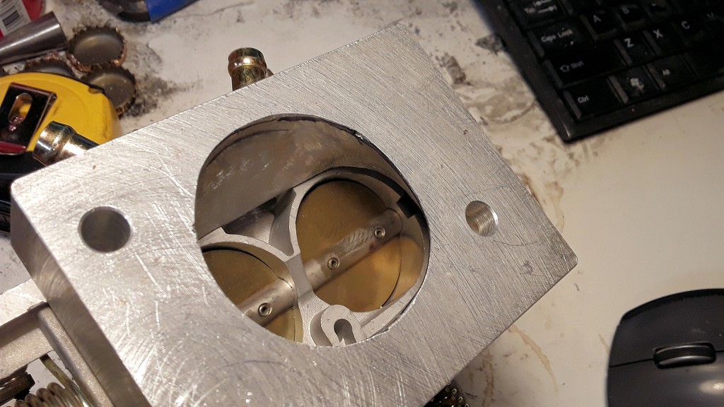

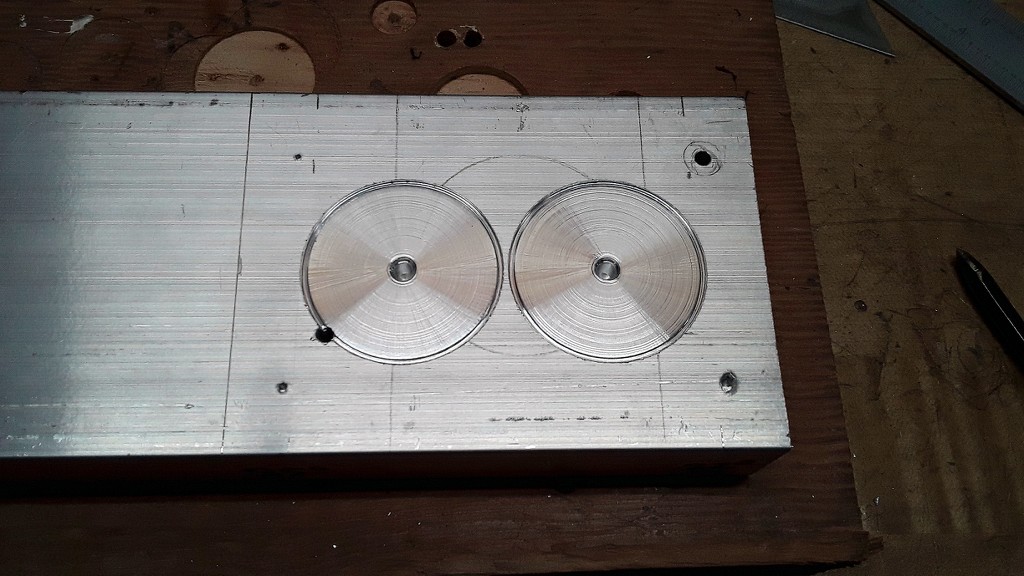

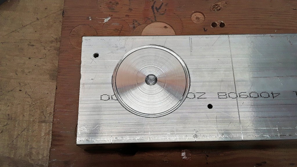

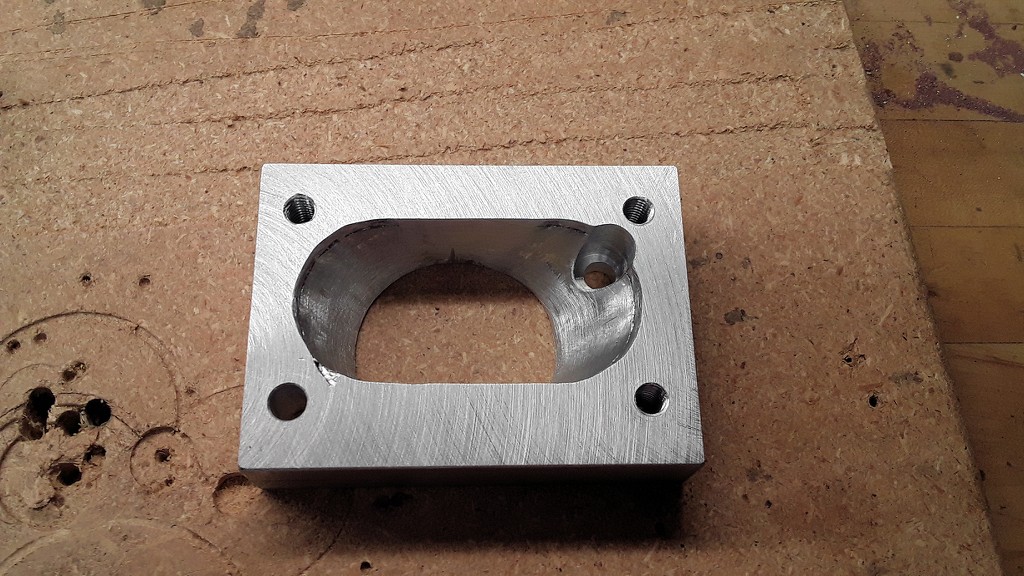

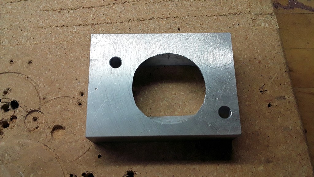

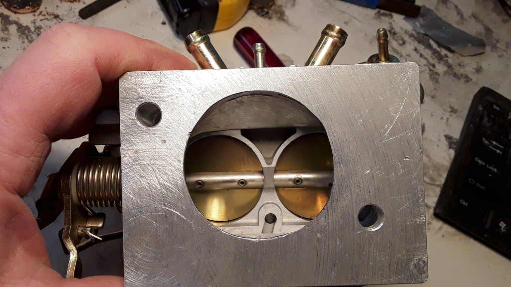

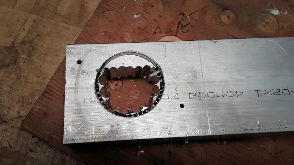

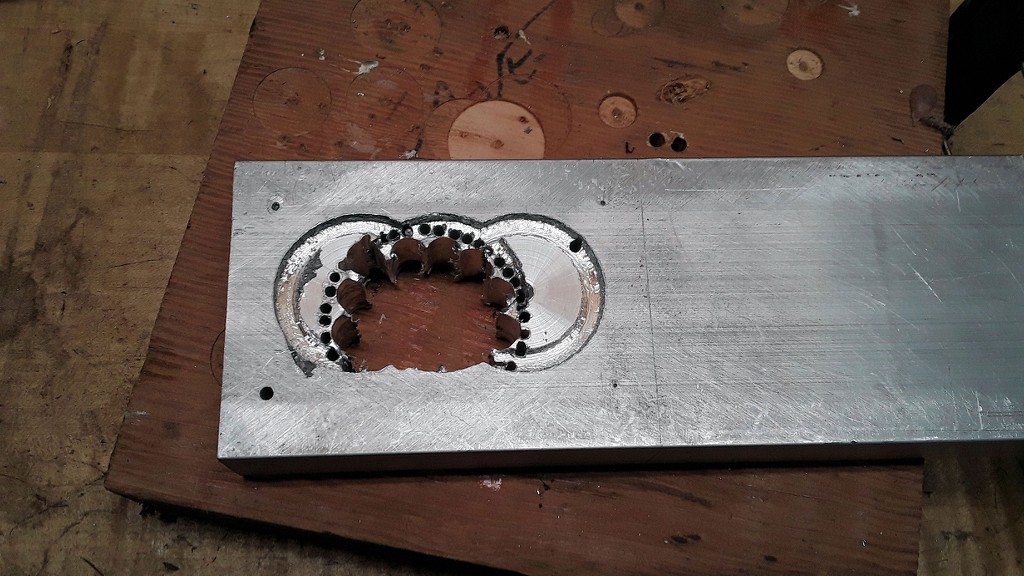

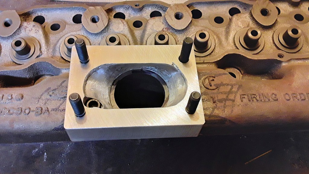

I've been working on this lately. I need to get this mounted so I can reconfigure my TV and throttle linkage for the Sniper. I still need to buy a throttle cable and find the time to get it installed. I've made an adapter out of 1" aluminum. The hole in the log will be enlarged to 2". Eventually the head will be swapped, but I'm still looking for a good head.

Chad, I may end up just having the current head milled, but I'm trying to get to this Sniper conversion done without having to have the Van down for a long period of time. Also, importantly, not spending so much $$$ all at once by not pulling the head right now. If I can find a good spare before I get to it, I'll convert the spare head. This BBD will sit in the same location as when the head gets milled and I can use the same adapter for the Sniper 2CG in the meantime. Right now I need to get the throttle converted to cable to get this thing mounted.

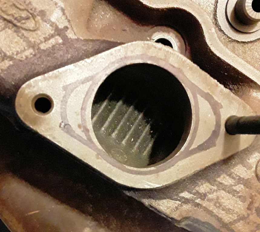

2" hole = 3.14 sq inches
1 7/16" hole = 1.62 sq inches
x2 holes = 3.24 sq inches
Only ~3% difference in area
And a stock 1.75" hole = 2.41 sq inches, 23% and 25.5% difference respectively than above.

It is 4 5/16" from the base to the air cleaner mount. Be advised the non jeep versions of this carb require you to fab a choke cable hold and use manual choke only. The use manifold mounted choke coils in their oem applications. Also it has to be mounted up off the log enough to have the linkage clear. Using a weber adapter would still require you to make another adapter or find one if they're made. The webber has a larger footprint than the small BBDs or 2GCs. Choke linkage at the top requires more height to clear.
The two vacuum ports pointing toward the valve cover. Could you pull the tubes out, tap the holes, and install plugs or 90 degree fittings?
Maybe. Or you could stick a rubber 90* on there and cap the other. They are close but not that close to the vc. With a 1" adapter you can get a hose on there no problem, even w/ a 3/4" adapter I'm sure. You need some rise for the throttle linkage anyway. If you cock the carb like 63wagon you have more clearance still.
Edit: Apparently c*cked is censored. Ahem, if you "skew" the carb. You don't have to skew it to much. Skew it just right to fit all the screws that need to go in and through it. The way that 63falcon4drwagon did it made the bolts work and maximized the area in the mounting pad that could be opened up. I guess clocking it is ok to.
