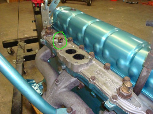

63falcon4drwagon, Dhat's what im talking about. Yippeee!
Avoiding a clash with the rocker cover or the passenger side head studs is always a problem if you start swing the carbs around. You've done it right!
63falcon4drwagon, you've identified the short turn radius, and how to stop it ghosting the air fuel mix.
Nice work 63falcon4drwagon. :beer: :mrgreen: :thumbup: :wow: :nod:

Its doing it 63falcon4drwagon with a 90 degree twist
Its likely to risk a sealing problem unless you devocon or jb weld extra margin, but it too will work.
I've found the bolt spacing matters prevent a lot of easy work.
63falcon4drwagon used the stock log head castings strengths, and his application is great.
Proof is in the idle quality. Idle is a key problem of a 1-bbl Ford, it's always bad compared to a 2-bbl or triple carb DCOE with 6 bbls in total.
I like the elongation 63falcon4drwagon has done, but I think swapping it 90 degrees, and then tear dropping the hole in the opposite plane is easier still. It then allows up to three BBD carbs. :twisted:

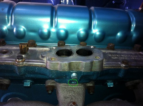

One of the things I liked about how it worked out for 63falcon4drwagon was b/c he was forced to skew it, it gave him broader coverage of the log. Happy accident. And the fact that he did it in situ and utilized the factory casting/pad. I did some math and there is an equal area on the oem carb mount that can be opened up. Compared to straight through 2 x 1 7/16" bores of a BBD TBI, ~3.29 sq inches can be opened up for the 3.24 of the BBD TBI. But of course the shape change probably affects flow and potentially for the worse.
At the end of the day I'll probably just mill mine off. It's easy enough to do if you pull the head and know someone with a mill. Which I do. I'm still waiting to hear back from Holley on the flow of their Sniper BBD. What I really love about the footprint of this carb is how it keeps you away from the area's of the log beyond the stock carb mount. B/c when you look at it both sides are moving up in relation to one another, esp the aft side. This means the wider you go the thinner it gets to bridge a flat spot between them w/o brazing a plate on there. I'm not worried about it being level. TBI may be less than ideal, but considering what we are working with, i.e. the log, a 2v tbi has got to be a huge improvement. Ideally it should be 90* to the engine but it's just way easier to mount it inline on the log.

I'm glad to hear that X b/c that's the way I'm going to mount it :D I've got a chinese 318 BBD coming so I can get this figured out. The 318 BBD is the largest of the small BBD's and flows 285 cfms from what I've gathered online researching. Calculating flow through the size of the sniper bbd bores I'm estimating around 400 cfm. Holley hasn't gotten back to me. It's more than enough to feed my warmed up 250 to beyond 4500 rpms(which it will never go). I've been looking at the linkage using my stock rod setup and I think it will be fairly simple to execute by moving the stock pivot fwd on the adapter and adding a throttle arm extension to the carbs arm. I'll have to move the TV cable setup fwd as well, but I think that will be fine.
I noticed today that Holley has released a small bore "2CG" version of the Sniper which is just the BBD version with a different throttle arm attached that is more like the 2300 w/ the throttle stud holes and stud holes for various kickdowns. That was my biggest hangup with using the BBD version besides the extra $100. Unfortunately this one costs $150 more than the 2300 :roll:
https://www.holley.com/products/fue...r_efi/sniper_efi_2gc_small_bore/parts/550-864
This base pattern will fit on a milled log with no need to fill anything, skew the carb or shift it fwd. Or could be used with an adapter and hogged out hole like 63falcon4drwagon's.

63falcon4drwagon":2mfcmcj7 said:
The more I drive my Falcon with the BBD 2 barrel the more I like it.
It's the best upgrade that I have performed on this old car.
My DIY manual choke is great.
Pull out the choke for an instant start then push it in to 1/4 for a fast idle warm up with out choking the engine and polluting the air or the washing the cylinder walls with raw fuel.
The BBD is a great carb for a 200 six.
With two idle screws-throttle plates there is no more uneven fuel distribution or rough idle.
Performance is outstanding over the whole power band.
Full throttle high RPM power is great.
The tone of exhaust and intake is now like a six cylinder race car engine.
I love it.
The Chinese carb has brass float in it.
From the looks of it and RockAuto info it is a 1971 Dodge pickup BBD carb.
I'll have no problem if I need a carb kit or what ever.
Without milling-brazing the head I can always reinstall the YFA carb.
My Falcon is now a hot rod!
