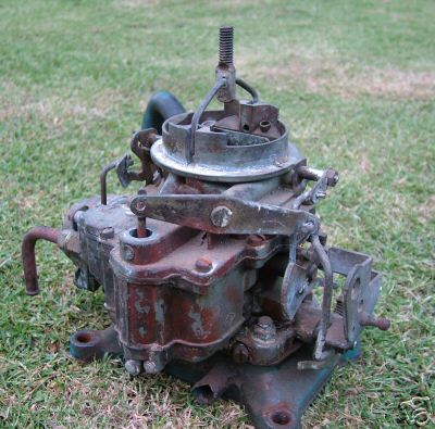

Same as the 69 US 318 LA, or B series 361 Dodge Adventerer pickup 2-BBL Stromberg WW 2-barrel carburetor carb, ID number 3-223a.
Details
http://i.ebayimg.com/images/g/bbwAAOSwu ... -l1600.jpg
http://i.ebayimg.com/images/g/S88AAOSwA ... -l1600.jpg
http://i.ebayimg.com/images/g/zHIAAOSww ... -l1600.jpg

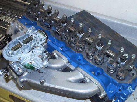

http://www.aus-ford-uk.co.uk/html/engines2.html
The 250 2V was only offered on the XY and XA model Falcons. For the XB, Ford reverted back to the ‘log’ manifold with a single barrel carb. The reason for this is unclear, but it may have been an attempt to encourage buyers up to move up to the new 302C V8 if they wanted more performance.
In the above photo, the inlet manifold has been fitted with a Holley two barrel carburettor.
From the factory, the 250 2V got the same Stromberg WW two barrel carb as the 302ci V8’s, shown below.

The GM version of the WW and the Ford version didn't have the Holley 2300/Rochester 2 Jet or 2100/2150 stud pattern, it was an oddball stud pattern. I have a WW250 2V base downstairs. A Redline adaptor was used for 350/500 conversions, I think.
