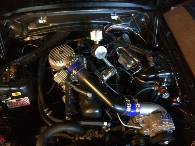

The small block six is a stout platform to begin with, so (IMHO) mild boost is possible as long as the engine is 'fresh' ,the AFR's stay in the knee and Ignition timing and boost levels are tightly monitored.

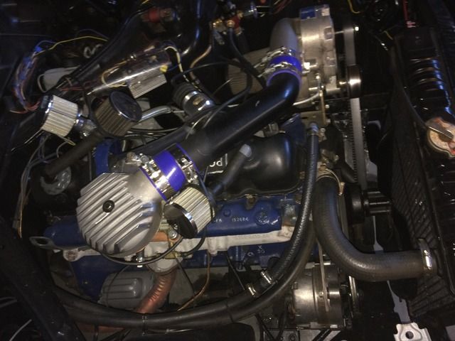

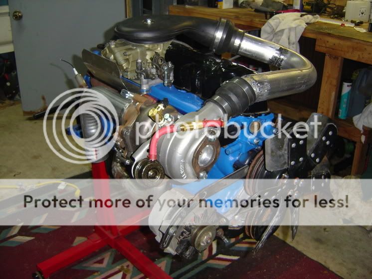

I've been running a 250 with carb and Vortech SC for @ 2 yrs for a few thousand miles with significant power capability. Boost is bled off to @ 5-8 PSI and AFR's and ign. timing kept conservative.
Current 250 is simply a stock block/cam with freshened cyl head but not milled for a SCR @ 8.7:1 with 'new' composite gasket and ARP bolts.
Previous attempt was a Turbo'd 250 , but after allowing increasing boost levels (@ 15PSI) , the piston ring lands broke off and engine spewed oil mist across windshield.
I look forward to more discussion on low boosting for moderate power gains.

[QUOTE=xctasy;1910094]Simplification of the tragically complicated EGR, AIR, Carb and AC kicker and twin cat exhaust wont make a jot of difference to a 200 acceleration rate, nor will slotting 3.23s or 3.73s. The problem is the carb and cam combination. Change those two, and your 3.3 comes alive.
Turboing with the stock 256 degree 370 lift cam is totally usefull untill the stock 1bbl fails to deliver gas to all six cylinders evenly. Then it breaks ring lands, leans out, and doesn't like 13 to 18 pounds of boost and 13.5, 102 mph quarter miles.
The little six just needs somthing like a 350 cfm Ford Carpenter truck carb, a TO4 turbo, a 264 Howards or Clay Smith cam, a T5 or AOD and then it can use 2.73s, 3.73s or anything if you dont rev it past 6200 rpm.
4.62s or 4.11s are what one 65 year old in Arizonaian uses to make his 500 Holley 2bbl 200 direct mount Falcon hit high 14s. Forged rods are best, but that engine can cope with its stock cast iron rods as long as the timing chain prevents cam to con rod contact.
BRWSaver and Lincs200 and Will and Kelly have experience with various versions of this latent old threasing and wood chipper engine..its stout, but its gotta have a great fuel supply to all six cylinders and a twin row timing gear without too many revs.

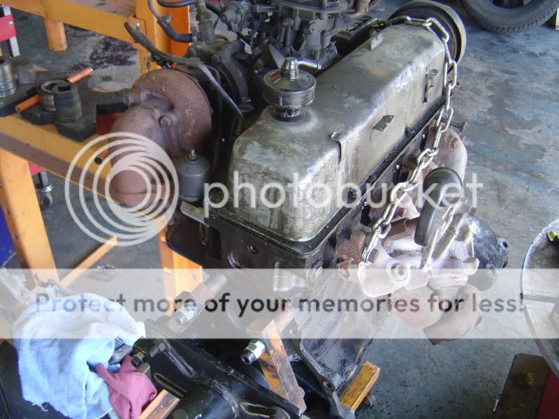

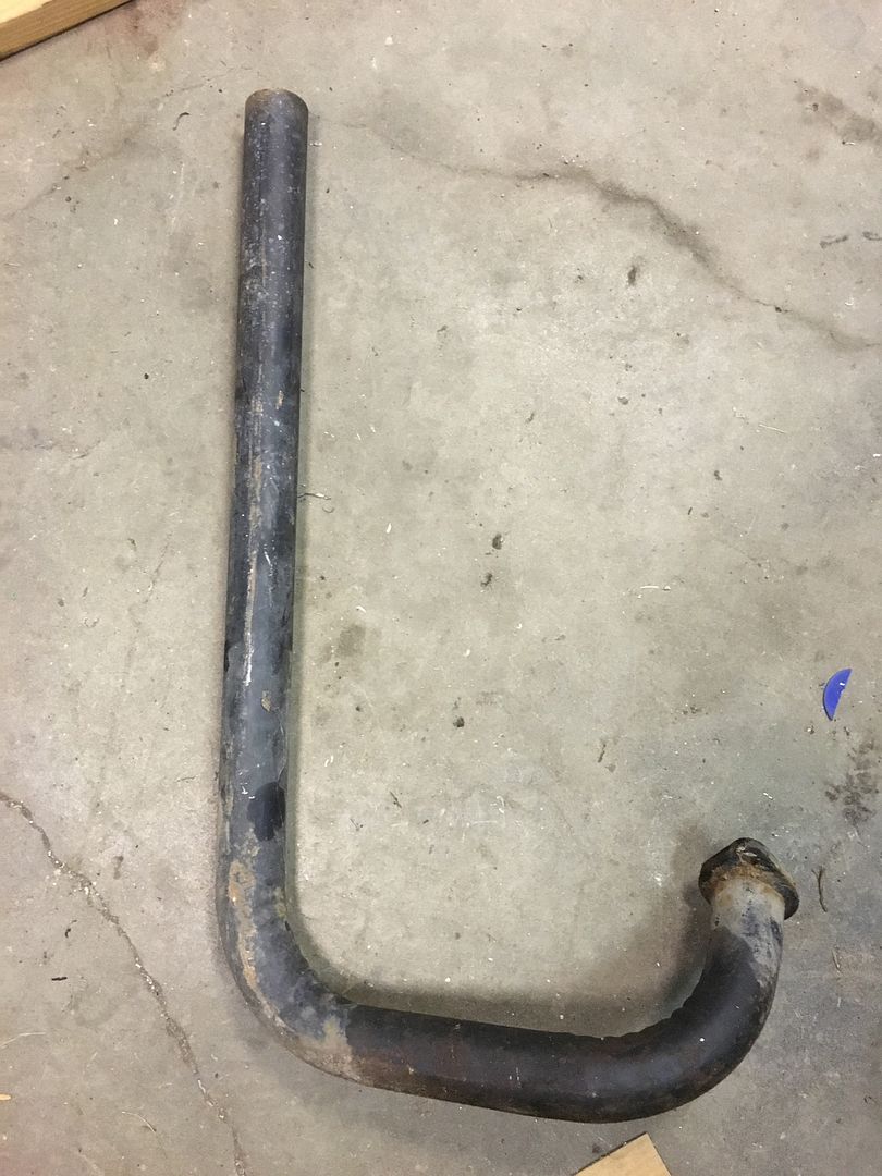

If you'd like to run a header exhaust, then run a 2300 Turbo Carb Mustang cross over and put the turbo on a bracket of the rocker cover on the driver side with a reconditioned T03 60 Garret off a carb turbo 79 to 80 Mustang. It is abke to make 230 hp at 12 psi boost on EFi engines; its effectively the Lotus Esprit Turbo which Garrett Air Research supplied to Austin and Lotus for many years. The Paxton or Innovi 4bbl Holley air cleaner bonnet flows well, lookes like a stock 2bbl air cleaner surround....and the whole Duraspark II ignition thing has a bunch of adjustability. The turbos had three kinds of boost retard control to the ignition. 5 crank degrees of Start up dwell by microsecond delay, and two other kinds of boost reduction of 5 crank degrees.
FirstFox and Deranged90 are the guys you need to copy. But keep the hot side well away from the passenger side, and copy a proper direct mount Crosley or CrBobcat style direct mount 2bbl. Dont starve a turbo of fuel, and dont be afraid of a long branch to a remote mount turbo.

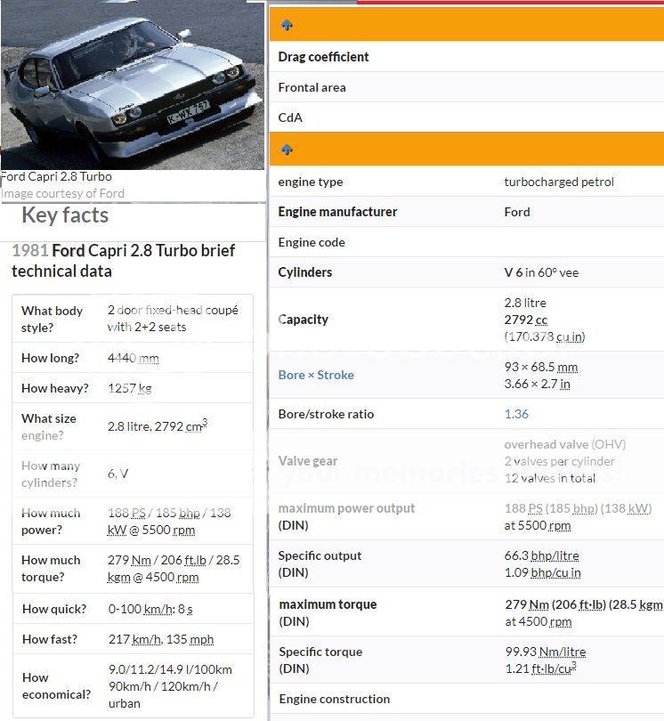

Ford of Europes 2.8 Capri Turbo and

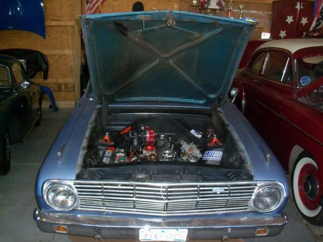

But when a 1961 Falcon tudor can make 280 hp with a stock 170 with triple carbs
gb500 wrote:and this 1960/61 falcon (XK) racer in Australia :
cut off log , some hose and clamps to the orig circular inlet stubs left and triple webers .
no trouble with hitting the suspension tower ...
this guy is in the Victorian early falcon club and races successfully .after buying the car off paul Knott
and earlier photo with different inlet trumpets

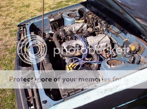

Nice work. I've had about 100 000 miles behind your engine in my Nissan Stagea RS4.
I got to hand it to Nissan. Your Ford might look like a rust bucket, but my 20 year old Nissan was a patchwork quilt of Iron Oxide. Putting the RB25DE into a Futura was a choice made easy!

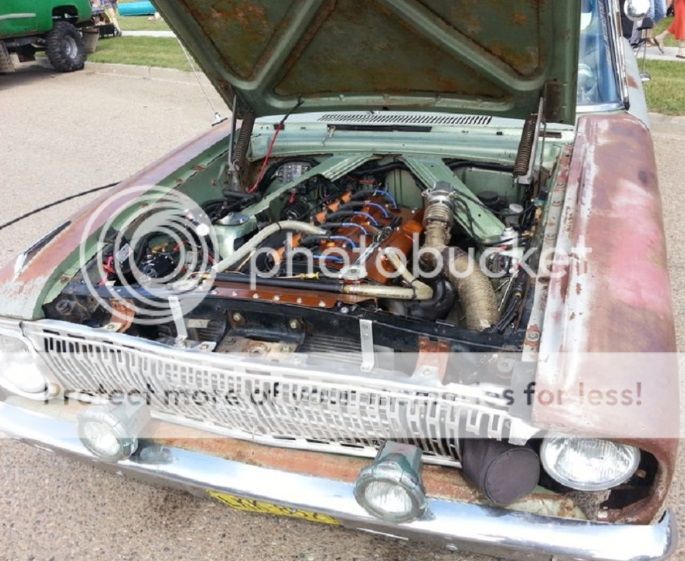

What I have on my log headed turbos in my signature isn't what any American would do.

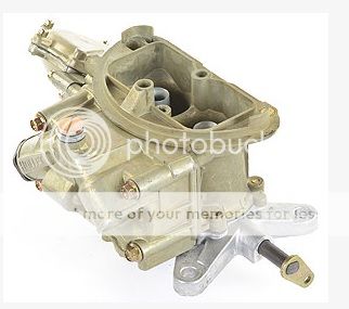

The second choice is no where near as good. Its Feedback 2150 Motorcraft carb has a 1.08 venturi, and controls air fuel via the EECIV and TFi interface. That is prefect with MS2E, and there is a project part to operate the air fuel ratio feed back off a wide band.
1st Choice carb. 4412 2-bbl 500 cfm Holley carb, and
put the carb mixture device sold by Northwest Aero Products on it.

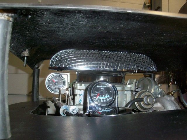

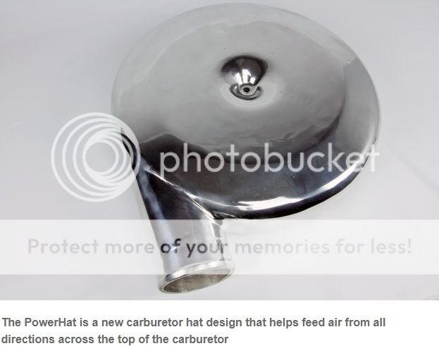

2. Air Bonnet Paxton single inlet
3. Carter Strip Dominator 350 Chev Fuel pump

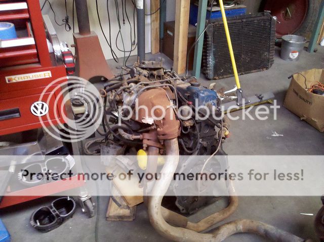

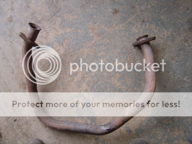

4. Hand made cross over pipe to turbo on drivers side (280ZX, 300ZX, 2.3 Mustang Carb Turbo position to avoid heat soak, copy Fords OHC 2.3 return line)

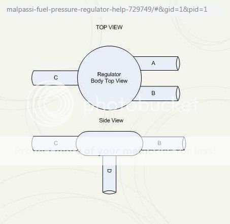

5. Malplassi fuel regulator ( There are many regulators off the shelf that will work with carby fuel pressures, Malpassi is a typical example)
the sides are fuel inlet and carb feed, the fitting on the bottom is the return line to the tank (you have to create one using the old inlet line, and a make a new line from the tank.
the small hose fitting is your boost source
6. T03 60 series 300ZX Nissan, 280ZX best yet, 1979-1980 2.3T oil supply and return line
Copy the Ford turbo clocking. Cold Air intake via a stock Fuel injected Dastun/Nissan/Holden 304 EFi Ryco A340 Cold Air intake
7. Valve gear and timing gear condition must be free from interference with the conrods. The 200 is an interferance engine, and the valve springs have to be able to resist over reving.
Ignition isnt an issue. The Duraspark II on the 2.3 Carb turbo Mustang had no pressure boost retard...it was controlled by the Controll Box which had a Yellow Strain relief, and three advance adjustments via three or five solenoid controls. TFi is my personal preference. On sub 8 pound boosts, your all good.

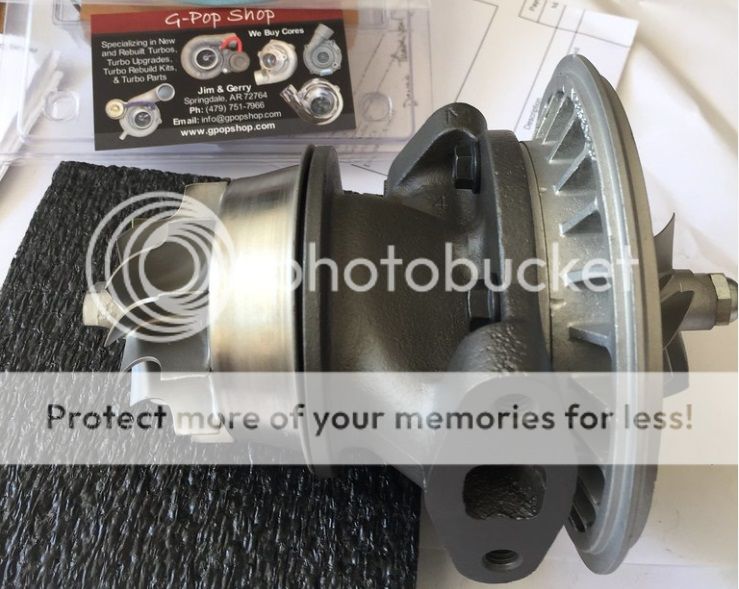

Alright so my search continues for parts.
Heres a T3 turbo for sale, it should this work?
I can't really see the oil line for the L4 turbo, but don't I just drop the pan, and weld in 2 fittings for oil to go in and out?

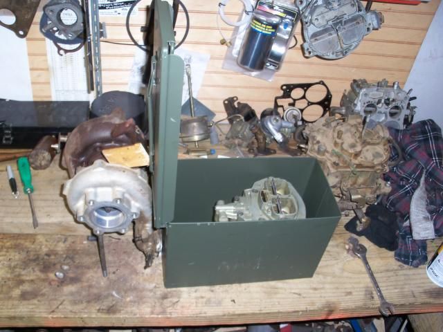

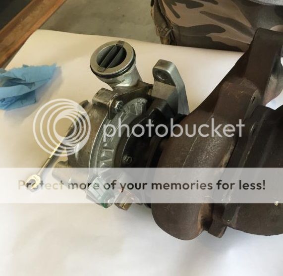

Your best options are finding an earlier TO3 60 from the era well bore EFi, and well before the Thunderbird and Probe IHI RB5.
The TBO302 turbo is an oddball version of a T03. You can use the newer bearing and the problematic carbon seal has a replacement.
It has the right parts to avoid extra fabrication
1979 to 1985-1/2 Turbo Ford 2.3, the carb ones are best. It has the right down pipe and attachments. Don't spend a dime on an ebay turbo.
Put an All Points Bulleten out for it, get it cheep. Then Rebuild it, have the parts crack tested.
http://www.mustangandfords.com/how-to/e ... rbo-repair
gregpro50, gr79 and M81 Mclaren from Four Eyed Pride have found all the parts

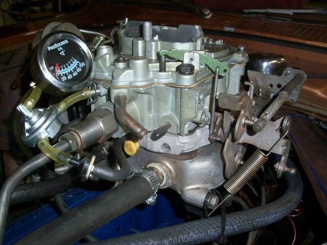

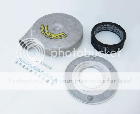

Item No 2. Novi/ Paxton Power hat for the Item No 1 2-bbl Holley 500 cfm
You can have it cromed so the Alien Motorship knows where to land...
3. Carter Strip Dominator 350 Chev Fuel pump as per hasa68mustang and kirkallen143
The best bet , the Rolls Royce mechanical fuel pump for a Ford I6, is the 120 gph Carter M4891 Super Strip pump for 350 Chevs It's a little X'y regards dollar purchase but it works.
Then you boost refrence it. For sub 9 psi boost, thats about it
https://www.theturboforums.com/images/imported/2007/02/engine8-1.jpg[
https://www.theturboforums.com/attachments/pump-jpg.459271/
General sub 9 psi boost level rules are:-
Dave Emanuel--Super Tuning and Modifying Holley Carburetors:
In blow-through systems using a mechanical fuel pump, the upper chamber must be referenced to boost so that the pump will develop sufficient pressure to deliver fuel to the carb float bowls. A sealed operating rod is also required so boost pressure does not escape into the crankcase.
The area above the pump diaphragm must be sealed off from the crankcase. By connecting this chamber to boost pressure with an external line, the pump will always be supplying fuel at its normal pressure above boost pressure.
.... you can see the modifications necessary to the mechanical fuel pump. Basically a fitting is threaded or epoxied in this case to the atmospheric vent on the side of the pump. I added two in this case to ensure adequate pump operation at high RPM. The other end of the hose is connected to the bonnet, BEFORE THE CARB, this is required. With this modification fuel pressure to the carb is increased 1 psi for each psi of boost to maintain fuel flow into the carb under boost. This can also be done with a high pressure electric fuel pump and a boost referenced regulator. Also seen here are the turbo oil supplys from the oil sending unit location in the engine block.

How people do a turbo is up to them. Kirkaleen143's
One of the big advantages of the driver side turbo is you can map all six cylinders oxygen sensor.
I copied the Argentinian header on my 200.
Image.
The Crosley style 2-bbl direct #4412 carb mount on D7's to E0 heads is so good
You have a huge amount of space, and a reduced amount of intake heat.
There is enough space to link six narrow band O2 sensors on this kind of header.
The turbo really only needs a custom pipe to and from, and can sit like it did in the 2.3 carb turbo
CoupeBoy made one
viewtopic.php?f=75&t=73236&p=583057#p583057
the front air inlet is held by two bolts and an O ring
the bottom oil line is held by two bolts and an O ring
the air to the engine is unsealed, and an interferance fit
the cross over pipes go to an existing cast iron gooseneck with a fully integrated wastegate

For the turbo, all parts are in service. Firewwod feels like it heats twice as much if you fetch it yourself.....I'm doing a 3.3 2-bbl Carb turbo kit!
http://vb.foureyedpride.com/showthread. ... rs!/page10

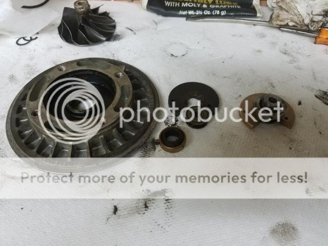

m81mclaren wrote:FWIW if anyone is searching for these turbocharger o-rings (NLA FORD D9ZZ-9G487C or more recently Fel-Pro ES72816) here is what I came up with Gargling and measuring with my digital calipers:
This turbo manifold inlet O-ring Ford#81141-S96 measures 2 ¼” ID , 3/32” width
This turbo compressor housing to manifold o-ring Ford# 87103-S96 measures 1 3/8” ID, 13/64” width
This turbo Oil drain o-ring: Ford # 87203-S96 measures 15/16” ID , 1/16” width
Turns out I have the housing and the big manifold o-ring new still from my FelPro master gasket kit and just need to source the oil drain one. Hopefully it's readily available @ the hardware or auto parts store.
Oil drain part is special...everything is special on Carb Turbos, but the are a great design, just wasn't any information on them that wasn't decried by the Toyota and Datsun import loving press.
The turbo can be updated to a better T04 shaft, and you can mix and match parts, but as a basic part, they are great.
And info abounds on them.
1. At 1:27, that is the compressor housing, not turbine housing. Also, it is the impeller, not turbine. 2. Your wrench is spreading because it is a cheap brand, buy something a little better next time. 3. Gator Grip, really? See comment #2. I'm not saying buy Snap-On but at least get the proper tools.
see https://www.youtube.com/watch?v=_iNZK4jeRSI

the approx 230 hp 1972 BroadSpeed Capri Bullet,
the approx 230 hp 1976-1980 TVR 3000M Turbo,
and the 188 hp net 1981 2800 Capri Turbo (Zakspeed via SVO's later West German guru, Mike Kranfuss),
These shared the same ET 78 gearbox on some US 2.3 versions, but with very close 65-73 Mustang T10/ TopLoader type ratios.
The Zakspeed engineered Capri III even had the American market 2.8 Mustang block. Ford USA purposely turbocharged the wrong engine in the USA, and forbade the factory turbocharging of the 3.3 and 4.1 in line sixes.

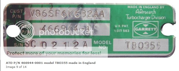

What is the model of turbo you keep referencing? And what carb is it? Its not a 2300 is it?

The Garrett GT2554R is the smallest of the dual roller bearing turbochargers and is about perfect for your application.
The best I can find is that it is an upgrade for some of the stock turbos found on some Nissan engines meaning you won't find one in the wrecking yard.

TB03XX= T03 with whatever fittings
When Garret was AIResearch, it made air craft cabin blowers, its growth was small diesels, included nearly all Mercedes Benz TD's with some exceptions made by Audis KKK.
The TB0302 was the first T03, similar to the Saab 99/900 Turbo unit, but used as well in the 1980 Turbo Lotus Espirt Essex and the later 1984 MG Mini Metro 1275 Turbo....then the 1983 2.2 K-car turbo.
In my opinion, the most versitile plain bearing turbo ever. It was sized to suit any engine from 1275 to over 4089 cc, with 2700 cc the sweet spot.
The new stuff is truly neat and well serviced, BUT for certainty of purpose, any old TB03XX will do if you can rekit it, and use proper long life fittings.
http://www.allpar.com/fix/holler/budget ... build.html
I will not dazel you with anything except early David Vizard turbo tech for 1970-1988 T series 1600/2000 EAO OHC Pinto engines.
See the David Vizards Modifying Fords SOHC engines book, ex SCRID, the turbo section is in Chapter 11, Page 131
https://fordsix.com/viewtopic.php?t=69374
xctasy wrote:Very expensive, and worse if you try and cost cut.
Factory system example is the 1975-1979 Mercedes Benz SEL 450 6.9. one of the best systems around. V12 Lamborghinis used it too.
Best discussion was David Vizards Modifying Fords SOHC engines, page 108 to 111.
He recommends buying a whole kit. Size wise, oil demands for a 5 liter I6 will be the same as a hard worked Pinto 2000.
http://www.scribd.com/doc/26804743/How- ... vid-Vizard
Aussies were making systems for racing in the early 50's on small I6 engines.
http://fordsix.com/forum/viewtopic.php?t=6557

The issues with blow through turbos is the same as draw throughs. Ford in 79 was way ahead of everyone with this.
What royally screwed FoMoCo was the non standard non turbo carb parts, and those vacuum lines that took a dump from wear or bad service. The key good thing were the check valves and dioodes, and the adjustability to the Vacuum Solenoid they had on the head. Ford used the HVACsystem as a vac reserviour, and that never made any work on faults very easy.
50 feet of old crappy vacuum lines and mechanisms that where an " invented fix"... they somehow went wrong when fiddled with in any way. That was sure the biggest issue.
You have to copy stock 1980's carb era turbo VECI' diagrams like the two blow through turbos, the Bosch K 1397 R5 Turbo 2's and 1655cc Hemi 1-bbl turbo Renault Feugo's.
They worked okay, and even the 1-bbl Solex equiped 1655 cc cars were more like EFi cars in the carb to turbo vac line diagrams.
If you use a stock DSII, you can use the null solenoids from any junked 1978-1988 Feedback carb Jeep or Ford to control advance and retard. The vaccum canisotr allows you to range the advance by an electric trip sensor, like a rehostat.
The check valves are very important, and I'd personally keep away from dual advance ignitions, because MSD's system is essentially a defacto Yellow Strain control box, and not always reliable.
here are the
checkvalves and
vac diodes to get.
On a blow through conversion, you sure wouldn't use a 5200 Holley Weber, but the so called "2300 series: Holley #4412 500 crfm carb, with proper Ford style vac advance routing, and choke removal. Holley Weber were 2300 carbs, NOT 2300 series Holley Paret Number 7448, 9917 or 4412 carbs.
the two parts are the
The key part to all this is a really basic and simple Vehicle Emission Control Information (VECI) system. Every car from 1962 has really had a raft of clean air regulation stuff progressively added to the engine. Ford did it all during the reign of the 200 from 1963 to 1983.
IMHO, the ancient junk yard stuff is the best aquistion, and it allows you to control ignition 100% just as pmuller9 is suggesting.
The service tech from Ford Dunedin told me early on....unless you understand orthodox emission and vaccum and ignition stuff, you'll create headaches from your doo gooder vacuum line removal ways. And it doensn't matter if its turbo, EFi, carb, or whatever.
He gave me the example of the smog and emmissions gear on a Pinto engine. He said the engines came from the same German plant, and any two Cortinas with them could be emissions mapped differently, but internally, the European and US and Australian engines were all the same. So I tried to learn about thoise systems, but its taken untill 2015 to 2016 to get it nailed. The turbo parts are a great source.
I'm just suggesting another way to nail the 2-bbl direct mount turbo blow trhough without unrelaible, non Ford parts.
The old TB03 series turbos have a good AR ratio and they are easy to mount, and the 200 Turbo blow through is the engine Ford should have turboed in 1978....but didn't. Because it would have created a massive issue with what would have stollen slaes of 255, 302 and maybee 351 engines.

A new TBO355 is very expensive.
The TB03 turbos for the Ford Escort have a very small turbine housing that will choke a 3.3 engine.
The Chrysler turbos for the 2.2 have a larger housing but still on the small side and again good luck finding salvage.
