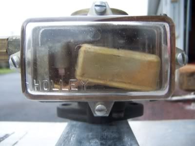

Generally the available Holley glass bowl 1904's are not going to make a performance improvement over other available carbs. Used on all sorts of cars and trucks of very different displacements, there are pages of "'List Numbers" with International Harvester dump trucks, 4 cylinder stationary engines, Ramblers and Dodges etc... . My '61 Comet / Offy TriPower has three 1904's, I have a collection of @ a dozen. I try to rebuild each but a few do not run well no matter what parts from working ones get swapped into it or passages get cleaned. I test-run each individually on my '63 170 Falcon before trying to get to work on the triPower . Worn throttle shaft bores and warped vertical bowl surface are common. There are many variants, some with strange choke plates used for jetting. You can be sure many available intact 1904 stashes from vendors are returned CORES - with problems' carbs ...
Holley 1904's on bikes?, a 'feature' of the 1904 is that the bowl vent is basically non-baffled port on top of carb and with moderate movement they spew fuel unless heavily modified.
if Photobucks allows:
NOS 1904

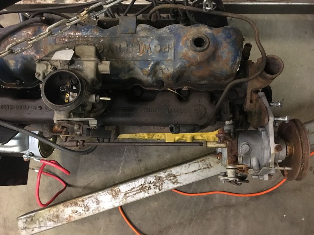

:hmmm: I've used the Mopar 225 Holley 1920 carbs on my 138, 161 and 201 cubic inch Vauxhalls too. Its a sensationally good carb, and it looks great too.
The only issue is distributor vacuum and how the throttles tip in to the engine.
Versatile 400 swather's or standby water pump's or wood chippers with 170 or 200 Ford's all used the repostioned 1904 Holley 1-bbl.
