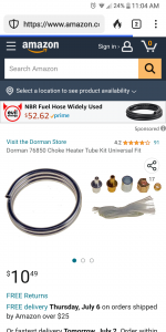

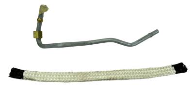

Hi Phins1372, that's a home made repair of the Hot Air Stove Pipe for the Carbs Auto Choke using a Brake Line nothing wrong with it being like that and it should remain open on that end. However if you wanted to shorten it so that its's just under the Exhaust Manifold that would also be ok and it will still function correctly in providing Hot Air into the Auto Choke Cover on the Carb. It should have an insulated cover like the OEM Hot Air Stove Pipe's had though for the best operation in colder weather (see below link for an example). Good luck
