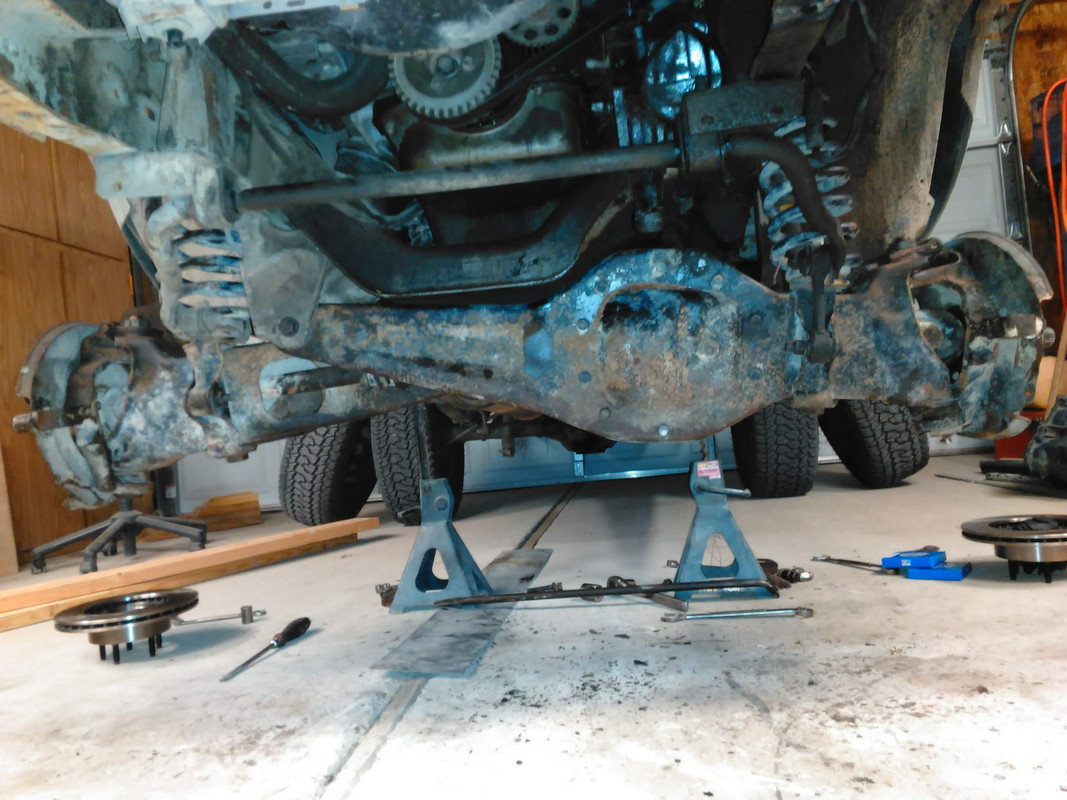

Body mounts are new. Getting the old body mount sleeves apart took the better part of a weekend.
Steering shaft had to be lengthened 1.5".

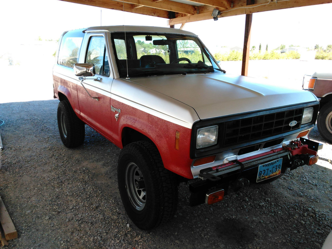

The body lift had an expected benefit. The header for a car application I had hanging on the shop wall now clears the evaporator plenum. Installed it and welded up some 2.5" pipe.
Going to work on making it all the same color now.
4 - 6 inch BL?
What sz tire (all 3 'aspects') now?

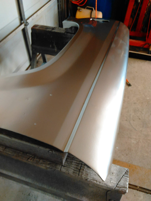

Didn't even C a fender change in all this. U said trim...
did U roll the edge or sompin? Hard 4 me ta C any but the frnt of the frnt...
nice.
I intended to roll the edge, but it looks good enough I may not.
Body lift with the 2" square tubing is 2", tires are 31x10.50-15.

"...Body lift with the 2"..."
WoW, the pic all ways throw me off. Looked like
4 inches.

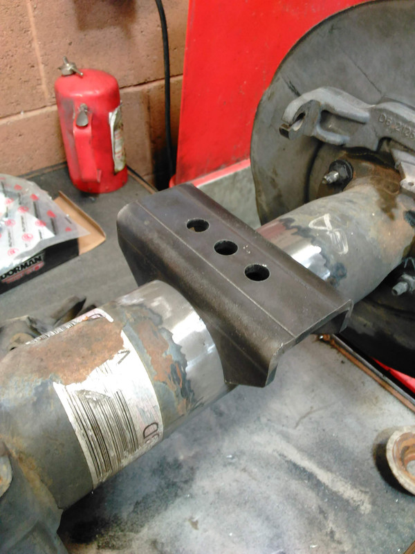

Explorers have 31 spline axles, but need perches welded on top of the axle tubes. About 1.5" wider.
Later ones have disc brakes in the rear, desirable in the event the C clip 'hat' breaks off for axle retention.
Keeping my eyes open, may score one from a 4.10-equipped Explorer if I'm diligent...

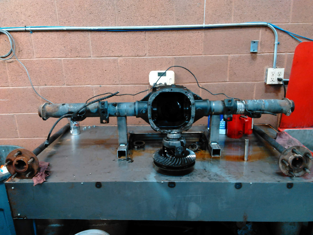

Much to catch up on. Axles, paint, and forced induction.
Rear axle is an Explorer Sport Trac 8.8 rear (31 spline) and front axle is Explorer Dana 35 TTB.
Ratios are 3.73:1. Needs to be ~4.88-5.13:1 to make 5th gear useable. I'm waiting for the turbo installation to chose ratios.
I'm hoping the disc brakes will hold the axles in in the event I break an axle 'C' clip hat.

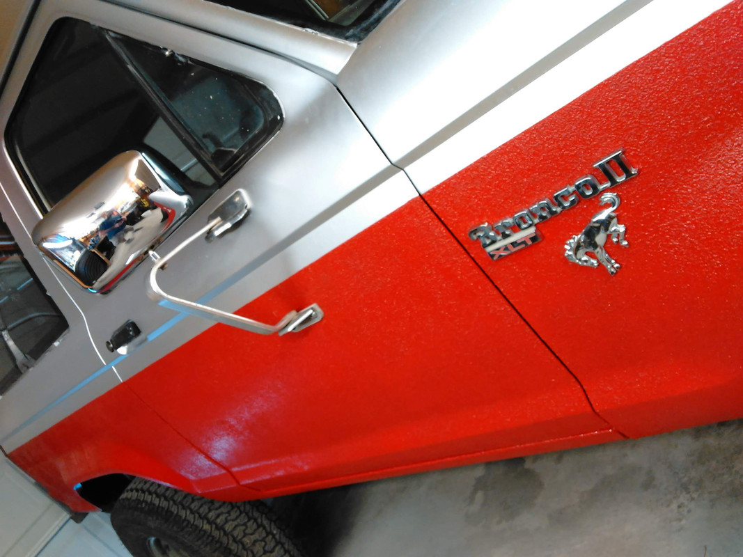

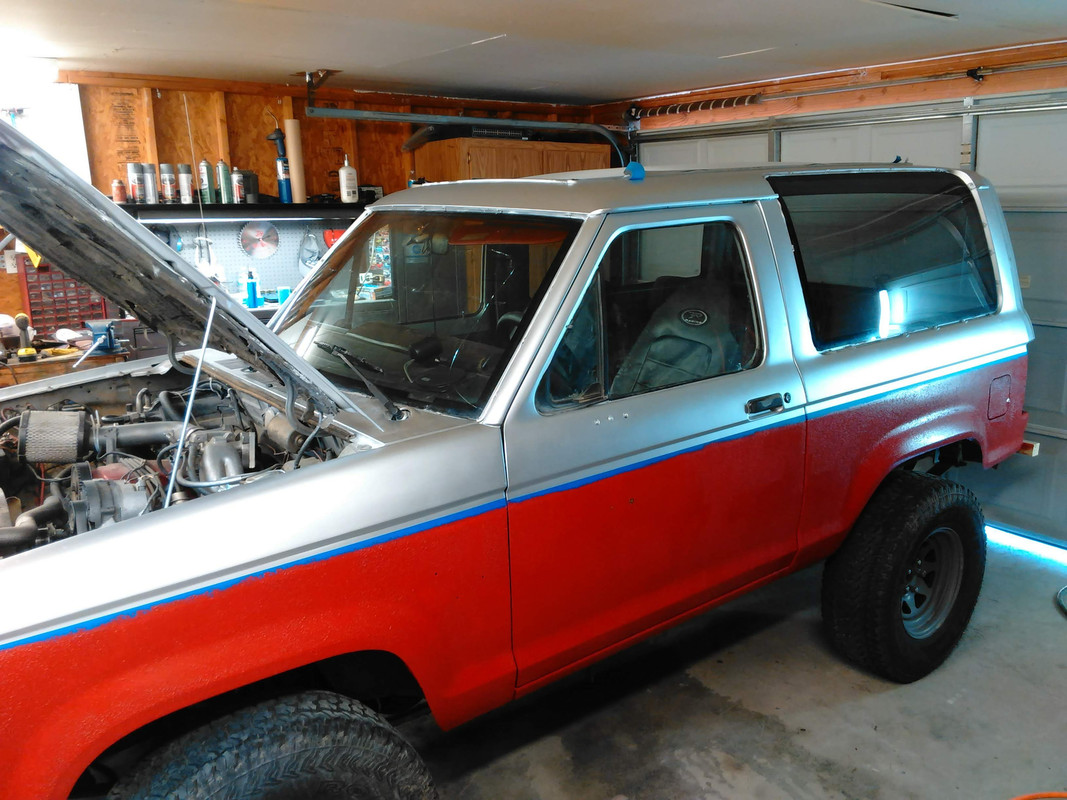

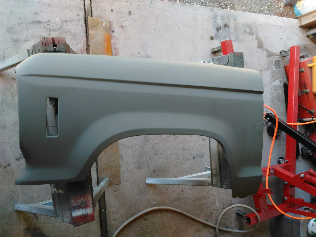

I decided on two-tone Rustoleum/bedliner. The Rustoleum will make scratch repair a cinch, and the bedliner on the sides helps prevent it.
The bedliner is Brick Red Durabak and I highly recommend it. Rolls on with a 4" roller.

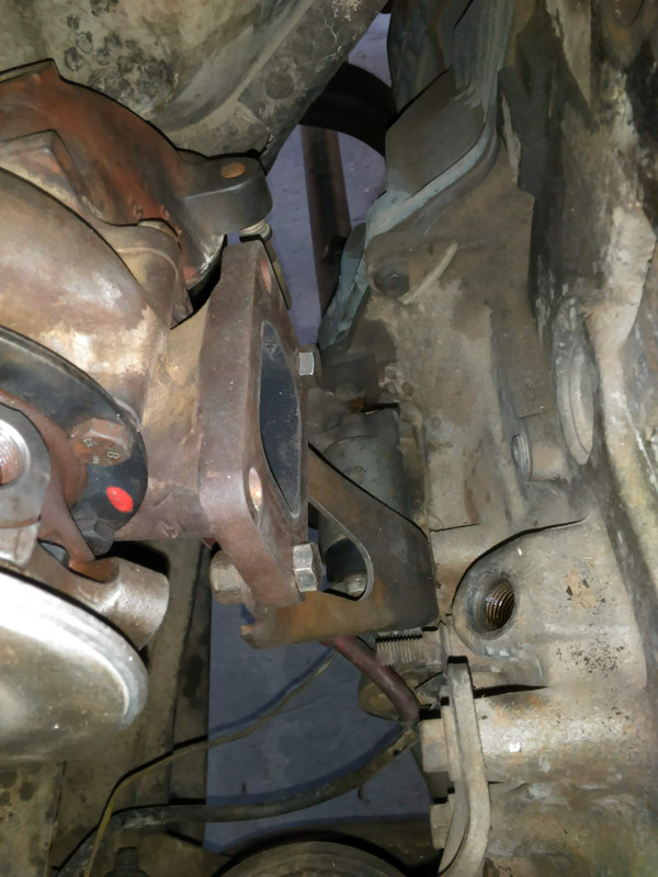

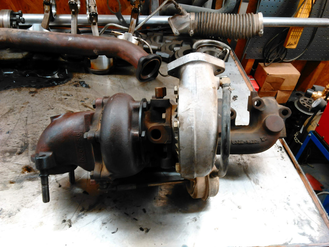

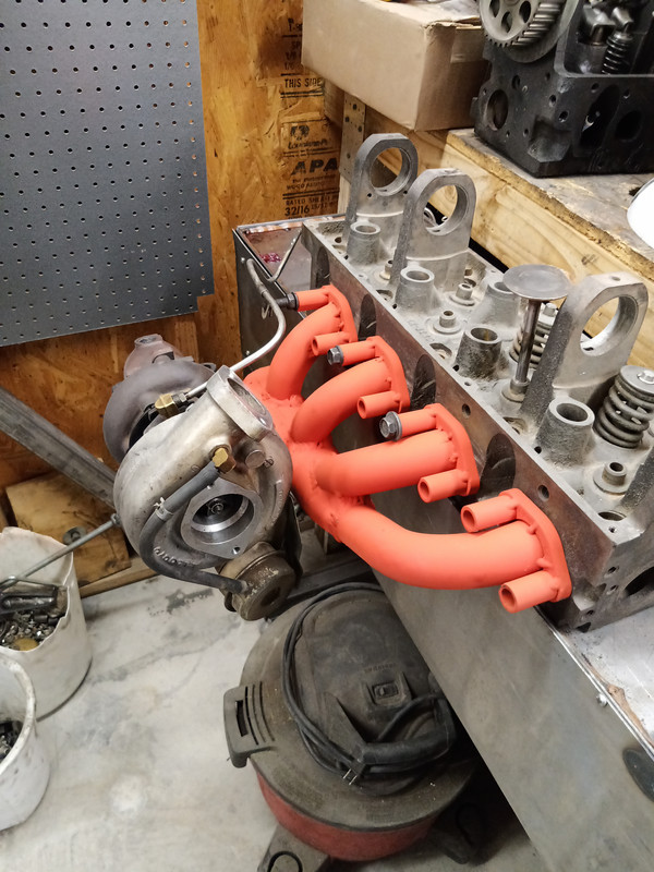

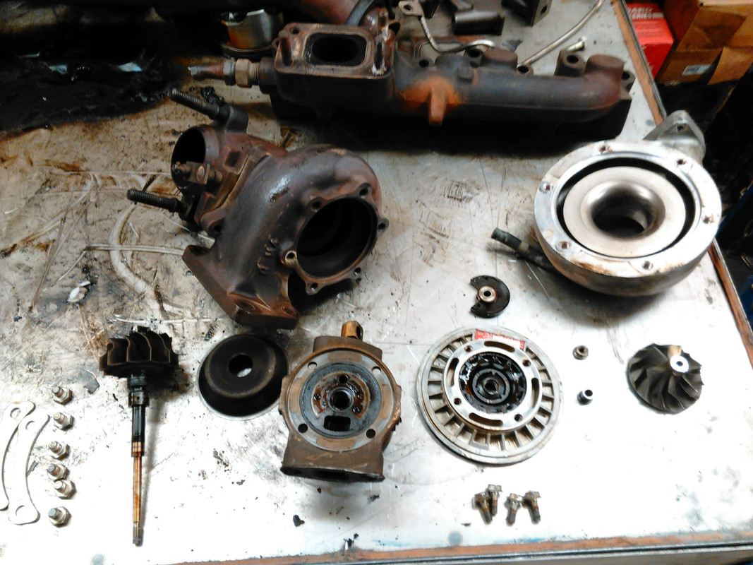

I rebuilt the turbo. It took two tries at getting the correct bushings. The housing was machined oversize during a past rebuild.
-It's a generic Garrett T3 off a Turbo Coupe.

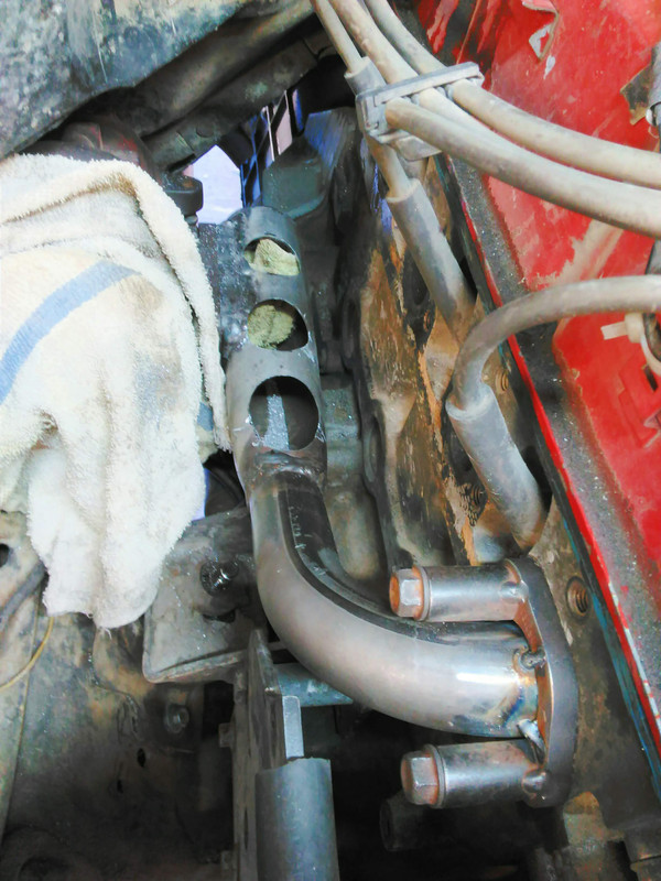

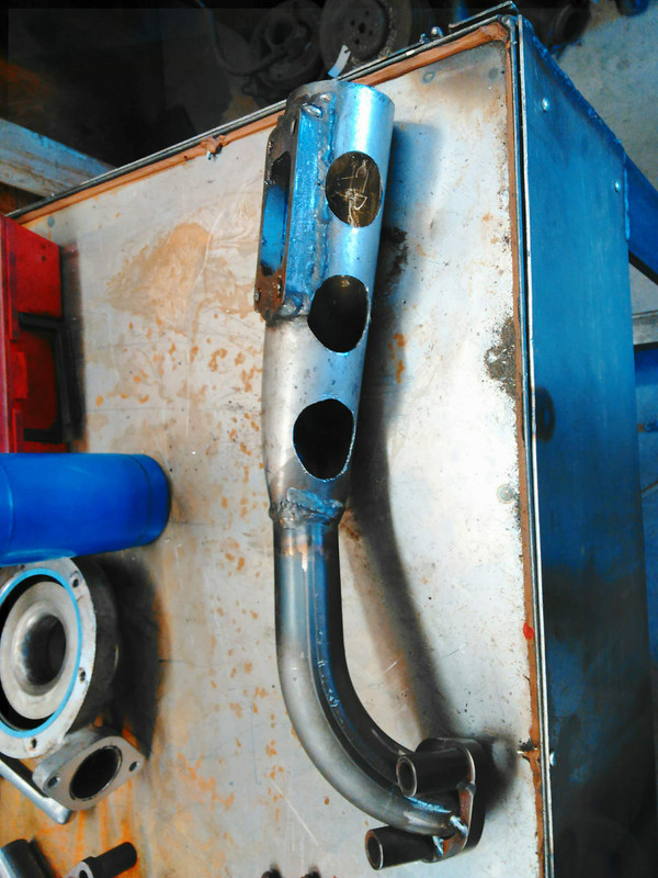

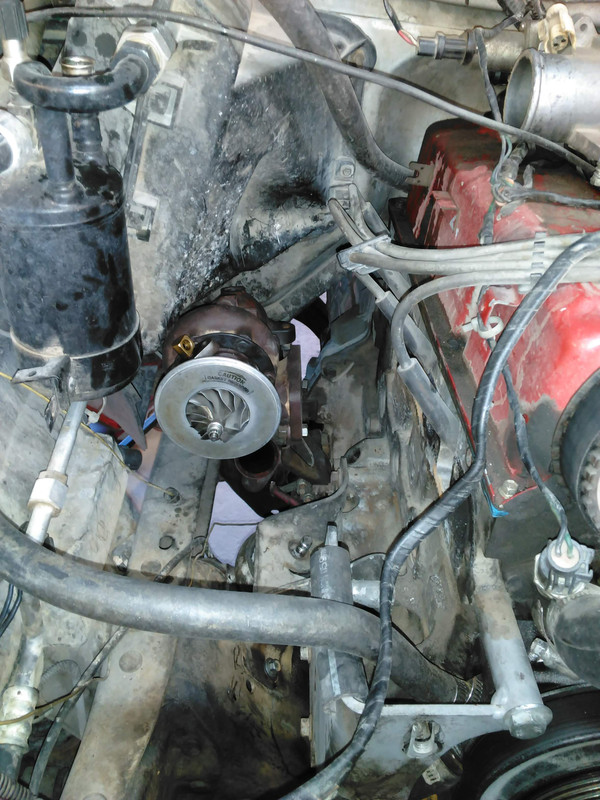

The 2" body lift helps, but the stock Turbo Coupe exhaust manifold places the turbo where the evaporator housing is.

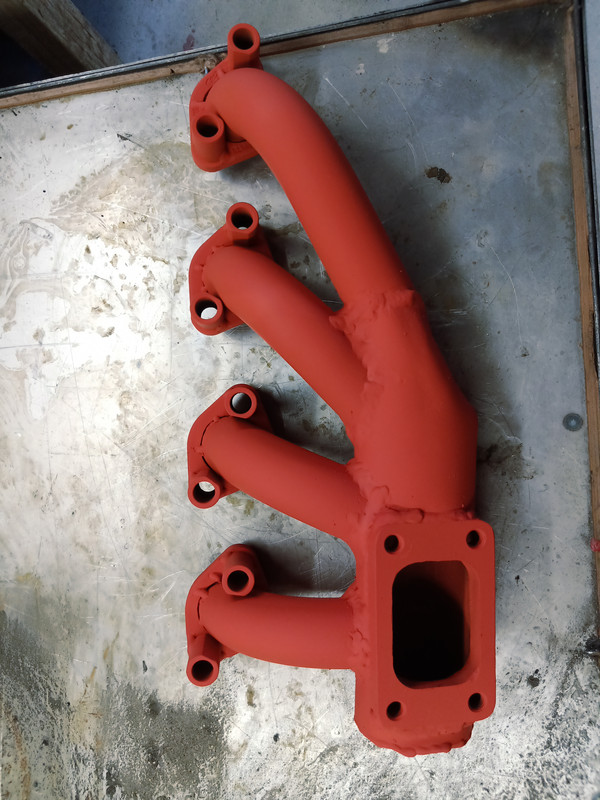

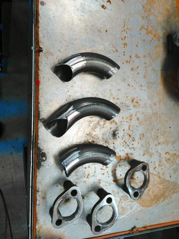

I will have to scratch build an exhaust manifold.
Mocking up the turbo with brace in a suitable location:
Manifold will be mild steel to start with. Yes, I know it may crack. This is proof of concept, if I'm happy with the result, stainless/schedule pipe is in the future.
