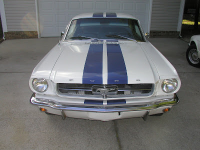

Believe it or not, we're getting a warm spell up here this week, in the Northern Freezer! These pictures were taken on November 4, 2007, thanks to JackFish:
From November 4, 2007:
I did the Division Bar Glass runs with flocked material because I couldn't get the mylar units, after restoring the division bars:
Here's some pics from December 11, 2007 with the Mexican Tarp Garage taken down, and all the trim back on.
Huge Thanks to JackFish for the Pics. This year I'll get my own Camera.

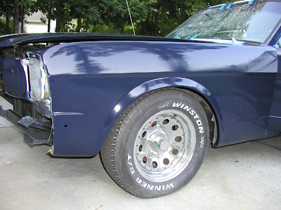

Just did the centers of my American Racing wheels and sprayed it with my cheapo Harbor Freight gun so I wouldn't gum up my good guns. I am very happy with how it came out especially since it was cheap paint and equipment.

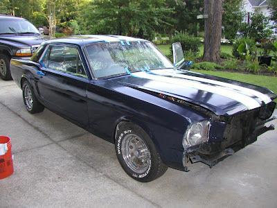

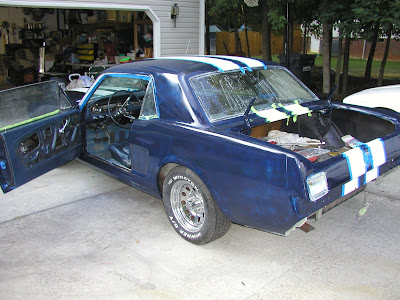

Since I have 2 kids to put through college, I thought the $3000 for a "professional" paint job would be best spent else where... So here is my roller paint job. I am probably closer to $200 but still a good deal.
Here is where I started from
and here is where I currently am
I still have a couple of coats to go and I am going to attempt to add pearl to the paint. I have tested rolling pearl on a spare fender I have and it looks pretty good.
Here is a link to the album for those who would like to see more pictures.
http://picasaweb.google.com/jl2odotcom/RollerPaintingThePony02?feat=directlink
