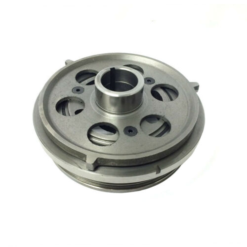

The 1996 4.9 damper has a 3 bolt pattern but it is a serpentine belt damper.IIRC there's a specific damper that has a 4 bolt pattern for a trigger wheel?
1996 fits 4.9L 300 Ford E150 E250 E350 Van Harmonic Balancer Crankshaft Pulley | eBay
FORD E250 VAN 96 4.9L (6-300). FORD E350 VAN 96 4.9L (6-300). Note : fits 1996 YEAR MODEL ONLY. FORD F150 PICKUP 96 6-300 (4.9L).www.ebay.com
I don't know.Eh, I suppose I could switch to a serp setup, but I'd prefer not to.
