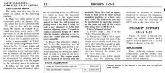

My '63 170 and my '65 200 both have adjustable over hydraulic from factory. '63 Ford Falcon shop manual supplement shows adjustment process for adjustable rockers over hydraulic lifters. Image clipped from shop manual.
Clearance measured between the valve stem tip and the rocker, with the lifter collapsed, 0.067"- 0.200". I don't think a solid lifter engine would run with that gap.
