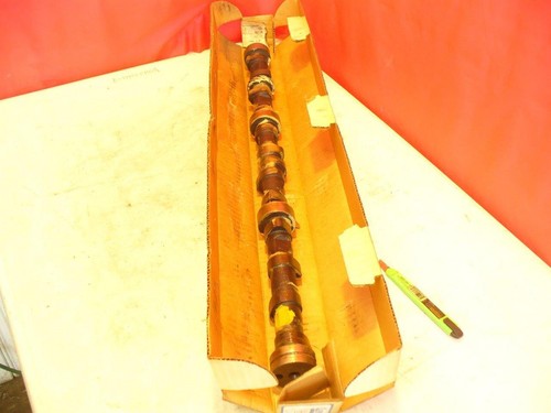

Thanks for the eBay tip. I didn't see that one. But I just bought a NOS TM 592 there, which is supposedly an equivalent part #, for a little less money. Just in case. Looks like NOS lifters will be harder to find.
