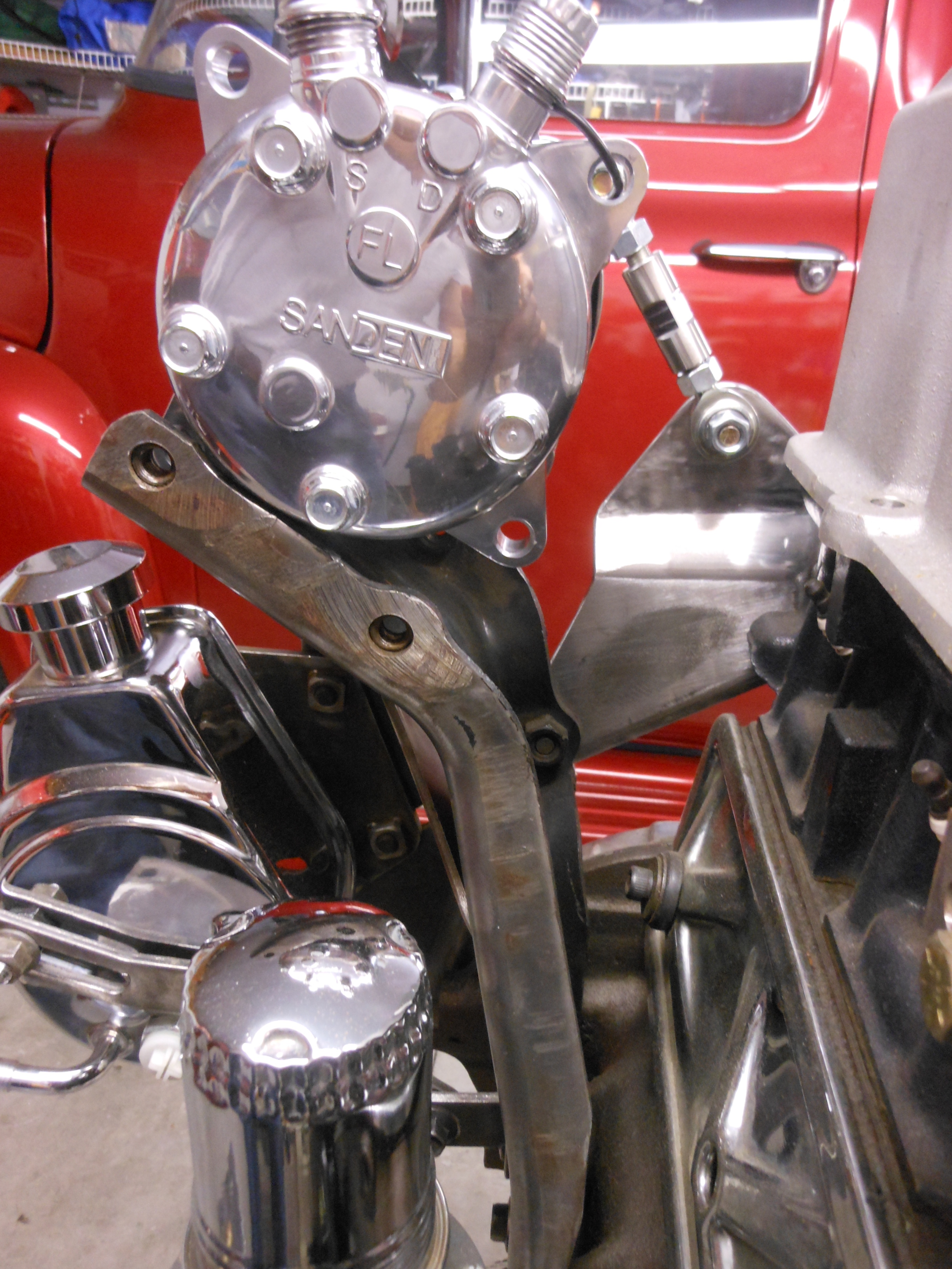

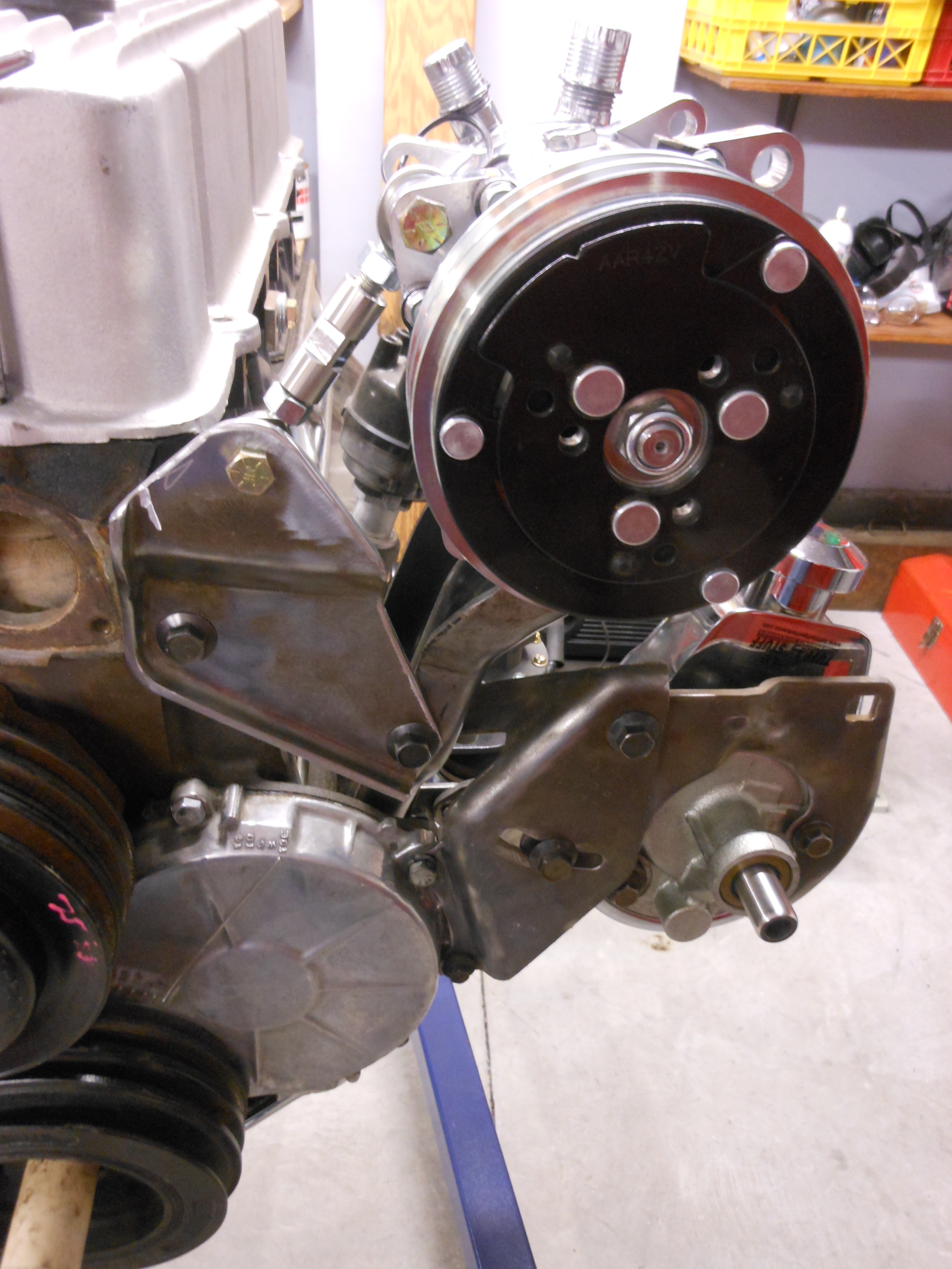

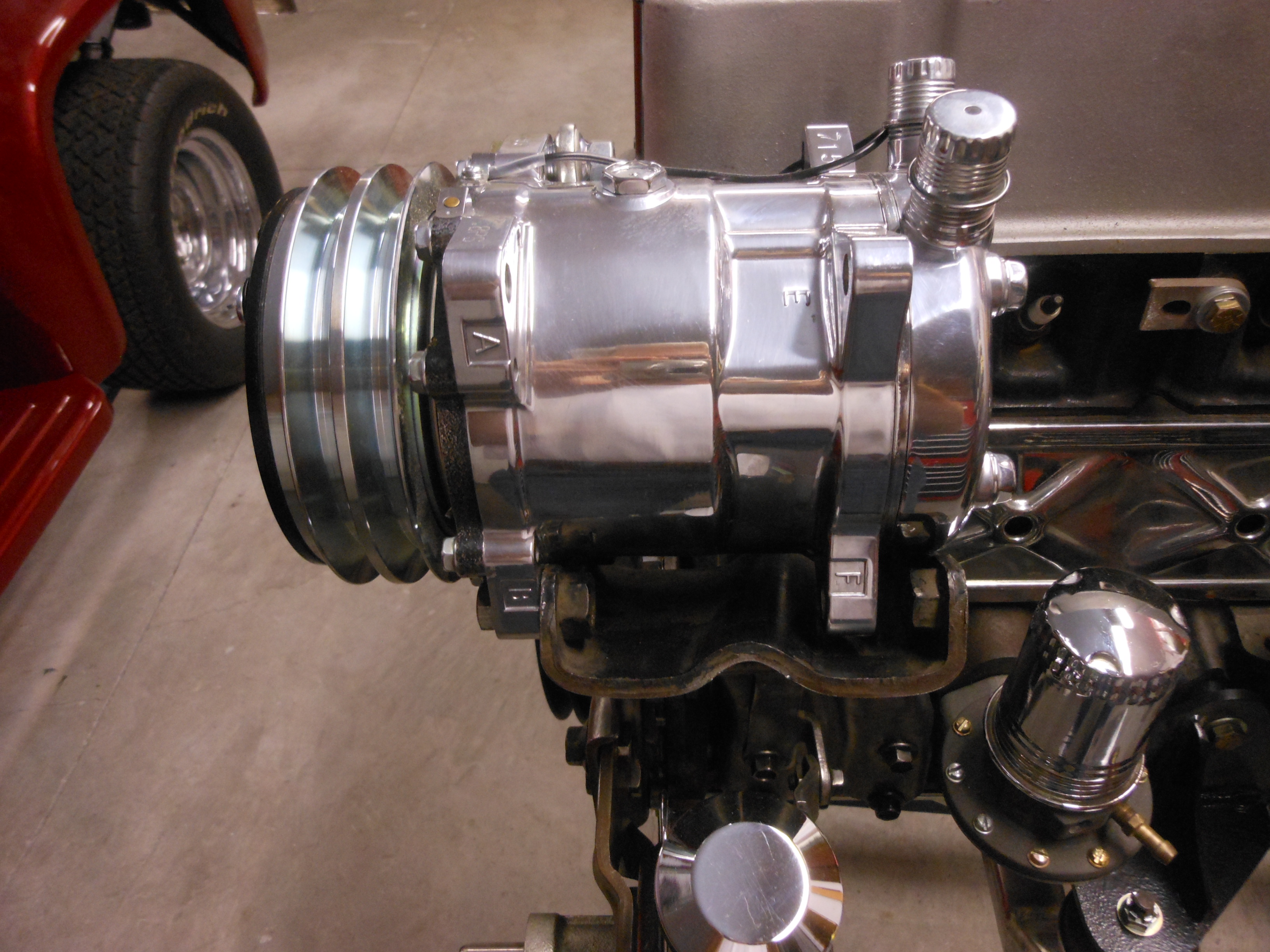

I've been toying with different stock compressor V-belt mounting brackets to see what would work best with a Sanden. I found that a 1983-1986 bracket works really well. If the Sanden is bolted to the face of the bracket the V-belt lines up perfectly if you have a 3-groove water pump pulley/damper. I chopped down the upper mounting bracket and installed a tension adjuster instead. All that's needed is a spacer between the rear compressor mounting ear and the bracket. Easy installation.
http://www.ckdesign-inc.com/images/Compressor/Sanden1.JPG
http://www.ckdesign-inc.com/images/Compressor/Sanden2.JPG
http://www.ckdesign-inc.com/images/Compressor/Sanden3.JPG
http://www.ckdesign-inc.com/images/Compressor/1983to1986.jpg
pikesan posted a lot of truly lovely info here on a/c. Most of the problems on turbo verses Air conditioning is pure ignorance.
Modern Sanden units are a smaller diameter barrel that are actually longer and create other problems
"https://www.vintage-mustang.com/threads/200-cid-inline-6-ac-bracket.1147300/"
