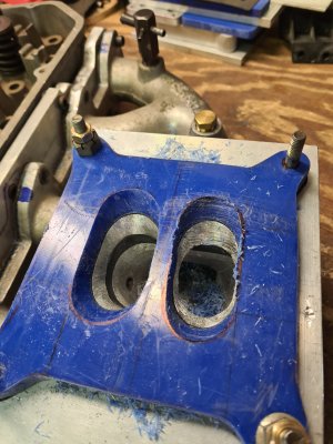

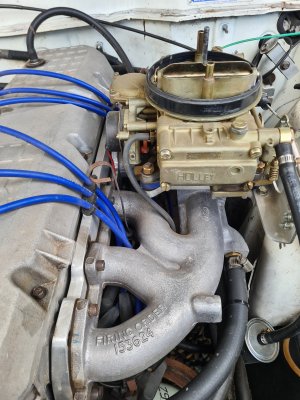

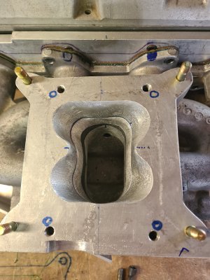

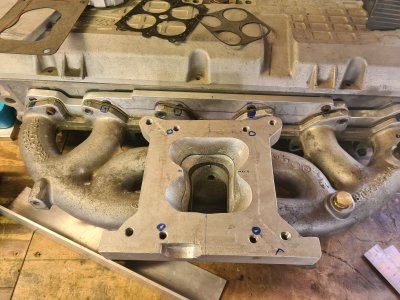

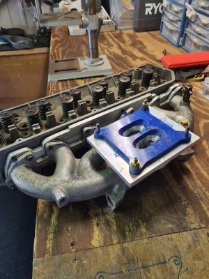

1000001298.jpg390 works ok on a crossflow, even kept the heated plenum, and the electric choke is a bonus..
There's a couple different attempts there but you get the idea. Just got it under an xf bonnet with a drop base air filter.
