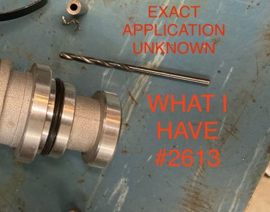

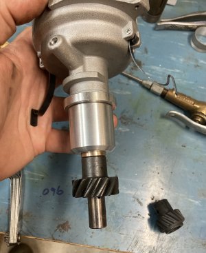

Looking for a small cap (points style) distributor for a 300. Apparently these have become obsolete. No HEI please.
I want to use it to upgrade my 223. I just finished adding a sleeve & gear to a WAI2613 to make it fit but I’d like to find a 300 and keep the 2613 as a spare.

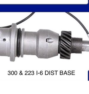

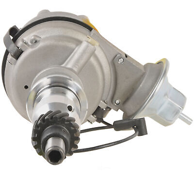

Notice the 300 and the 223 have a different base than the (240 etc) and they are all unavailable.
The 240/300 use the same distributor. The one I posted is for either, per your thread title. Neither fit the 223 as they come.

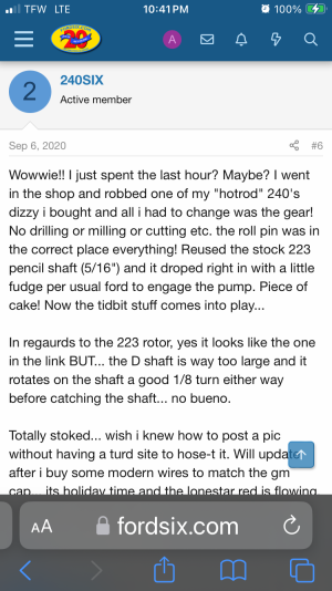

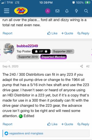

According to multiple posts on this site, the 240/300 will fit after swapping on the 223 gear, which I have already done on the mystery distributor that I have. Thanks for your input anyway

I got 'cha man. I do not know what mods are required to make the big6 distributor fit the 223. I have a 240 and a 300, the distributor is the same, and they are readily available. That is what you asked as the subject of the post. :)
