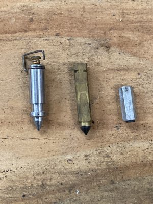

Make sure the needle and seat are a matched set / style. If the needle you installed is different from the old one then the seat is likely different as well.
Here are a few styles that I found in my Holley 1904s. Each kit came with a needle and a compatible seat.
Good luck!

1)verify correct size needle/seat, set correctly
2)verify clean fuel
3)verify fuel pressure.

@Adriatic Machine It could be a needle/seat issue as I literally just dropped the walker needle in (it looked identical).

Update - Replaced the needle and seat without luck. Pump is not adjustable. As mentioned float was correct...SO
