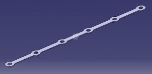

For the shimming of the rocker shaft I was planning on laser cutting some sheet metall like that:
Any thoughts about that (good/bad idea) or things I have to take into account?

That does not at all look like what I described for a shim. That has a lot of material where it is not needed, and no material where needed. The rocker will teeter back and forth without full stand, base support.

Regarding the shim, it is just a schematic yet, so the proprtions may not be 100% correct. I understand that the base surface (red circle) has to be fully covered. I connected the individual shims to align them, is there a disadvantage in doing so? Do you mean that 6 separate shims would be better?
Once you figure out what thickness you need for a shim, you can use one long piece of sheet metal that covers all six pedestal mounts as a shim.
You may have to clearance the long shim for the pushrods.
