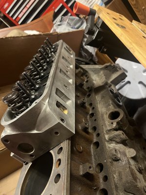

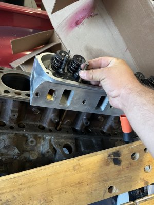

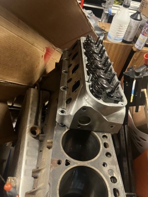

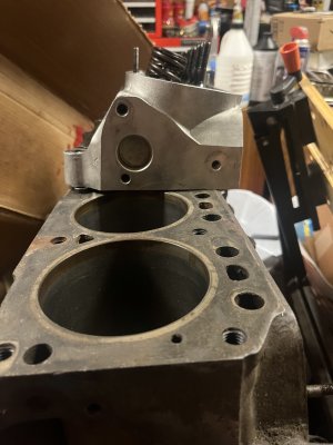

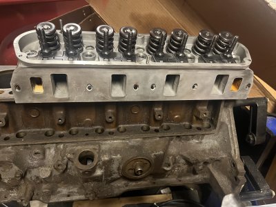

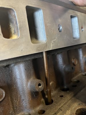

Hello all, I have returned yet again. Been absent since I had to sell my truck last summer to feed the family. So recently I came across these no name (chinese?) aluminum heads for SBF on fb mp. Im assuming they arent gonna be great so they might make a good candidate chop them up and make my own cross flow head. I do know the sbf heads valve are opposite of the 300 and will require a custom cam. I wont mind taking my time and slowly spending the money to making this work. Plus i still dont have anything to put it in either to road test.

Its gonna be a project i take my time with. I have other projects to get out of the way before i get to this one. The first step is to see if they are still good, so have them tested and if they are i may just use them on a 351 build. But if there is a crack like i thought i saw on that first cylinder then i could cut that one out and make my head. I was just wanting to go outside the norm of everyone piecing together LS heads.

I know its not a perfect mock up but it looks like it may reach and clear 🤷🏽‍♂️
