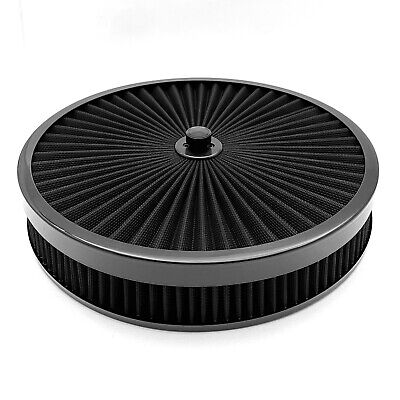

Found this air cleaner on ebay that seems suitable do to having side and top filter elements:
I wonder if this cleaner would work on the current carb. Not sure if the 3" height gives clearance to the hood.

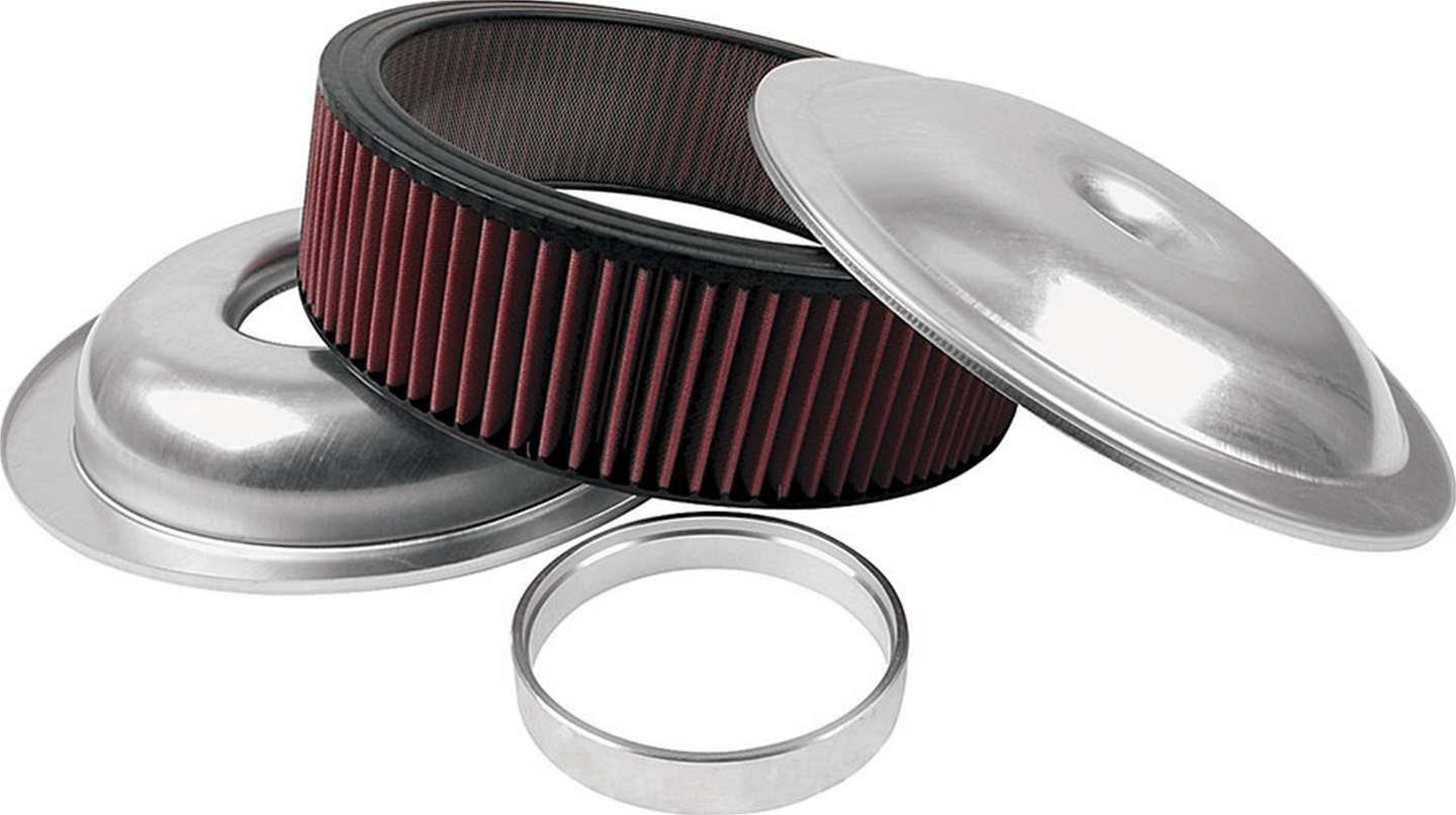

Try a dropped base one. Like this one. Different sizes available.
In terms of even airflow for vent signal and metering, this is the best of your options. Not saying the hat won't work. The hat will change it's effect on mixture based on which way its facing relative to the carb. Visualize the tall bowl vent with it's tapered edge, and the airstream going past it toward the barrels. . There's a reason it's cut facing away from the barrels.
The biggest drawback to the open style is the hot air supply for the carb. It's more significant than may be thought. 1% power change for every 5*F. The hottest air under the hood is at the top. If it's 60* hotter under the closed hood (at times way more than that) than the ambient air, that's 12% power loss. A 150 HP engine just gave up 18hp due to the open-style air filter.
The last thing to consider is noise. This may not bother you, just a reminder that open breathers allow the engine and vacuum noise to escape.

I'm less familiar with Holley and Ford carbs. This reveals I was a GM/Mopar guy for 35 years before getting the 300 truck. LOL. The rule of thumb is 2" absolute minimum from the seat of the filter where it sits on the carb, to the top of the filter. Holley's have a high choke tower and even higher bowl vent than Rochester carbs, which had the 2" limit. It's not hard to surmise that only 1/4-1/2" space between the top and choke tower is not going to be sufficient for accurate high demand metering.
If you get the filter with the open top there's no problem except hotter air and more noise. If you could fit a drop-base filter then that helps the flow and allows the top to be closer to the vent. The drop-base improves the carb overall, because the air is smoothed and curved before entering. fluid going around a curve wants to mirror that curve on the other side of the apex. The drop-base curves it upward and it naturally mirrors that curve and turns down into the carb. The most power a BB Chevy made on the dyno testing different filter designs was with a factory drop-down 14" round filter housing with double snorkels. Double digit more HP than no air filter at all. This test was published by the designers of the Quadrajet in the early 1970's. .
At this point the Jegs open-top is your safest bet for correct carb function IMO.
