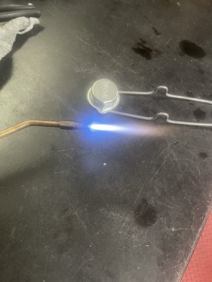

I didn’t want to start a new thread so figured I’d ask here. I’m so close to being back on the road! New radiator, heater hose fitting and all lines in. Last thing was the thermostat. The left bolt on the housing went in fine. The right bolt won’t torque down. Gets close then slips out of the threads and spins. Ugh! I weirdly just put the housing on (without thermostat) and did a water jacket flush. Then when I went to put it on again with the thermostat in it, it now won’t tighten. Is this a re tap job on the block? Open to advice ln this one.
