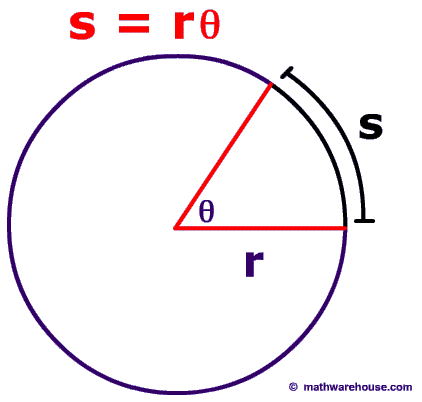

I can help. Done this many times with all my carb swaps.The answer is If you don't have enough gas pedal movement for smooth operation, you have to move the point r to get the right S.
Pedal travel is a function of how far out the cable on the throttle is out from the centre of the thottle axis.
Pull out equals S
S = rθ where
S represents the arc length,
θ represents the central angle in radians and
r is the length of the radiuss the cable is pulled through
1 radian =57.3 degrees
Any Holley 1-bbl or 2-bbl carb should have 80 degrees of pullout, or 1.396 radians, less a degree or two for kerb idle position. The Carter may be different, so the point S is not as good as the stock Autolite/Motorcraft/Holley standard.
Normally, there should be a hole about 1.4 to 1.75 inches out from the centre of the thottle trunnion. This is r. When turned through 1.396 radians, the total pullout S at the carb is about 2 inches or so, and, depending on the pendant lever arm, about 4 inches as=t the gas pedal.
Quite often we hook the accelerator cable up at the wrong hole and get insufficent travel. There are Cruise control and kicdown holes and accelerator cable holes, but the right one is the one that gives full throttle just a sparrows fart off the floor,
Pull out equals S
S = rθ where
I had it on the furthest radial support. I ended up fabbing something quickly in order to add an inch and a half or so to the radius. It helps, but the angle is wrong and at full extension it does not allow for complete WOT. It's maybe 1 or 2 degrees remaining, so it's almost all of it. Enough for me to live with for now.
You know, I'm taking trig this semester. I should have thought of this. I have no excuse.
